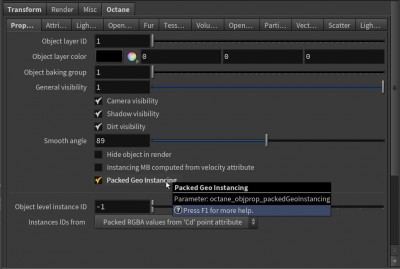

The "instance" point attribute can be used to instantiate arbitrary objects. You only need to set the right path for the object to be instanced in each point, but in any case, Octane 2020.2 supports packed geo instancing at the SOP level if you enable the "Packed Geo Instancing" option.
