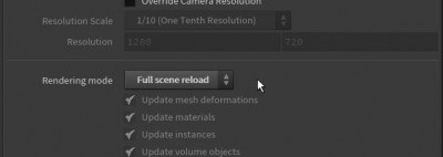

Hi all. I have a stretch attribute coming from a Vellum sim. 0 - 1. It's a balloon inflating an deflating. When its stretched out it's 1, when i'ts loose it's 0. I follow these steps exactly https://docs.otoy.com/HoudiniH/HoudiniP ... attributes. It works, but it's not animated. The opacity isn't animated. I should become more transparent as it stretches. What am I doing wrong? Cheers

Probably you are going to need to render the scene in "Full Scene Reload" mode. The mesh updating doesn't take into account changes in the attributes.

Amazing! Thank you!
