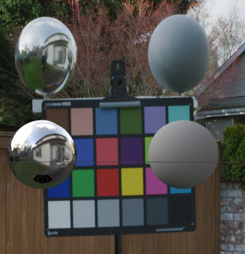

Thought I'd ask this again to see if anyone had a suggestion. The top chrome and grey ball is from the background plate and the bottom chrome and grey ball are rendered in Maya and Octane. It's light is from HDRI environment.
I used the Octane metallic material on the chrome and Octane diffuse set to 50% grey. Not sure if that's the best way to create these.
Any ideas on how to color correct the HDRI so I can blue tint to it?

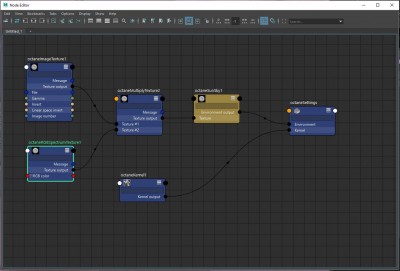

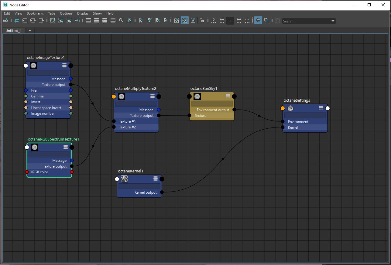

Hi, you need to use the node editor and create those nodes :

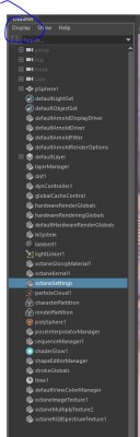

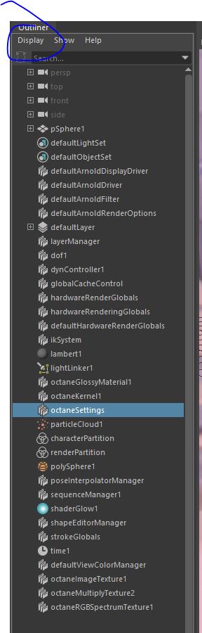

to access octane settings you need to go to outliner and in display menu , uncheck DAG object only :

alternatively, is the issue maybe a white balance setting in octane, or due to the contrast ratio of your HDR (depending on how many EV stops there are, the sky color vs the sun color's contribution is pretty heavily affected)?
I'm sure the multiply solution provided will work fine, but it seems like it could be a band-aid (which may be fine for your purposes). Just thought i'd point that out as something to look into, because I could see simply color correcting your HDRI as being potentially problematic in some cases and not fixing the root issue.
