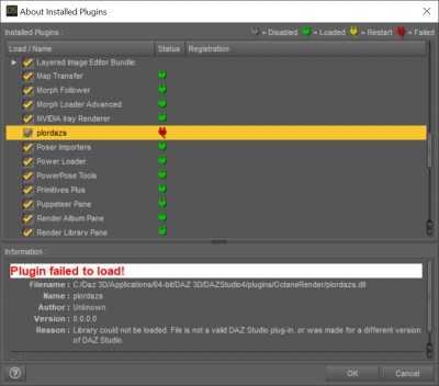

Hi BK,
Thank you for the update! I am having the same issue as Sorel.
When I check for OctaneRender in the list of installed plugins in DAZ below is the error I see. This is in DAZ Studio 4.15.0.2.
Error in DAZ plugins list

I'm afraid I'm not seeing this as well. I am also seeing the same thing huakiami is.

huakiami wrote:Hi BK,
Thank you Huakiami,
Yep, we are able to replicate it on our end.
Will get this fixed ASAP!!
cheers

BK
Posts: 1475
Hiya,
Thank you so much for your patience and sorry about yesterday's build!!
The builds have been replaced just now, please let us know if the `plordazs` issue still there.
cheers
Kind Regards
bk3d
huakiami
Posts: 48
Joined: Thu Nov 21, 2013 6:09 am
Studio version is now working for me and I can enable the Denoiser on my 3090. Thank you for the update!
Sorel
Posts: 264
Joined: Tue Feb 25, 2014 5:22 pm
Is working on my end now as well, thanks!
