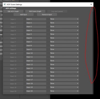

I have a simple scene that should take 22 second to render. But upon reponing a crashed Max scene, the Octane viewport would take ~20 minutes to display.
I digged further and found that AOV bug can be the culprit.
I do not intend to use AOV, and I cannot delete these inputs neither (my Max will freeze).
Could you please assist?
3Ds Max version: 2020
Octane plugin version: 2020.2
Link to scece: https://drive.google.com/drive/folders/ ... sp=sharing
Millions of AOV inputs created - bug

Hi efforce,
Thanks for your scene!
It is corrupted, so several other items may be wrong, not only the list of AOV inputs..
But here is a way to fix the AOV problem:
-Install 2020.1.5 (viewtopic.php?f=80&t=76181)
-load your scene, and resave it with another name
-re-install 2020.2
You should be able to reload your scene, all the AOV inputs should be cleared
I hope that will work for you.
