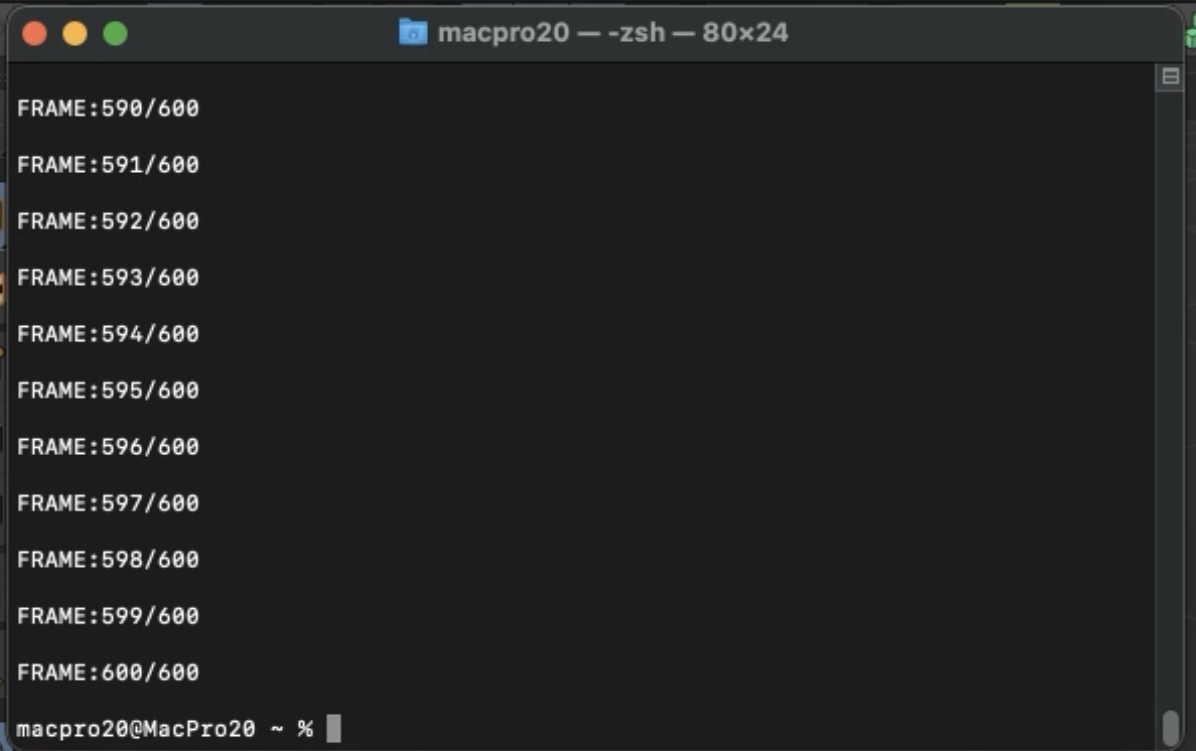

Please follow my instructions on how to export the .orbx scene via C4D command-line, you don’t need to use Standalone:
viewtopic.php?f=139&t=76283&p=395753&hi ... nd#p395753

Thanks. Tried the command line option. Can't get a save ORBX file from it. It runs and then no file.

Ok, we figure out that the issue was that I forgot to say to press the space bar after dropping something in the terminal window.
Now also snahbah has tried this solution, and has worked perfectly, without issues:
Not only, exporting in this way is incredibly fast, compared with the normal export, the -nogui option is very useful in this case :D

yes confirmed, the issues is still not solved in PR8, but the command line method is working 100% also with PR8, please, give it another try.
