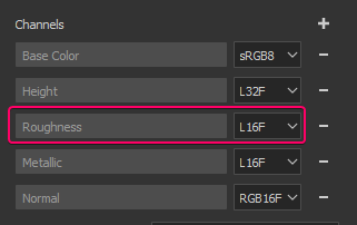

In particular, I've noticed problem with the roughness channel. I export it from Substance Painter as 16bit grayscale image with Linear profile:
Setting for roughness channel in Substance Painter

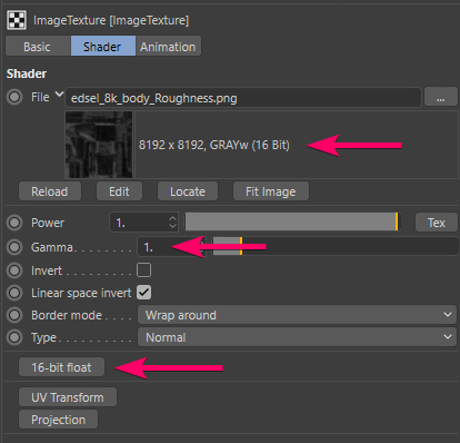

In Octane I add this texture to the Universal material like this:
Import settings in the Universal material
I here I set Gamma to 1, because it's Linear profile. But, to say the truth, I'm always confused with those profiles. That's why I also tried 2.2 gamma. And here are the results:

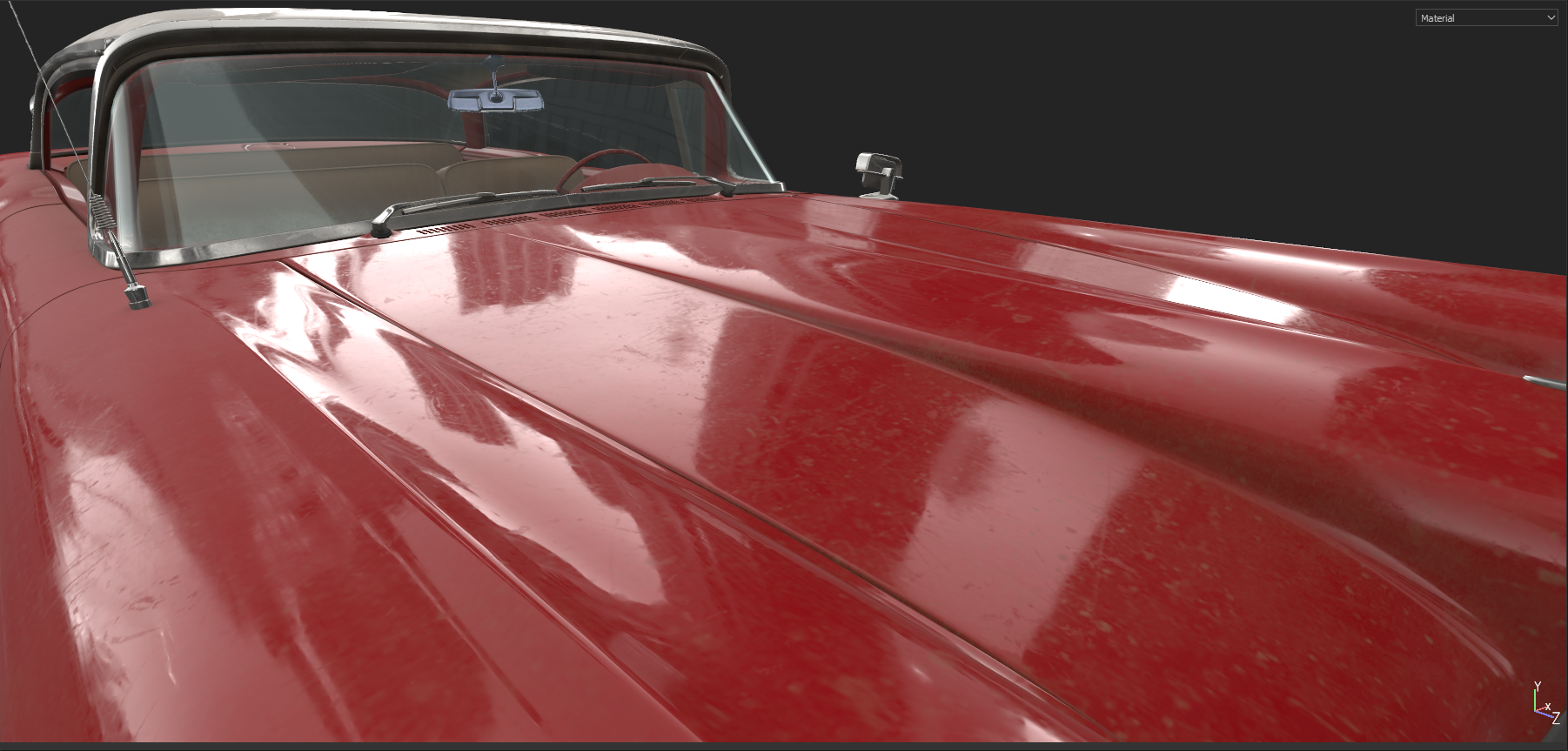

Reference look in Substance Painter (pay attention to the roughness):
Reference look
Reference look

As you can see in both cases (gamma 1 & 2.2) there is no match to the original PBR look from Substance Painter. But this cannot happen in the PBR. That's why I think maybe I'm doing something wrong at some stage? Please, advice.
Of course, by trial and error, while manually adjusting the channel's gamma I could achieve the material look which is close to the reference one. I've stopped at 1.5 gamma. But why 1.5? This is not how the PBR workflow should look like.
