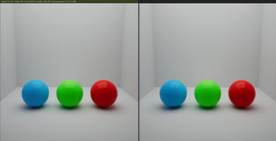

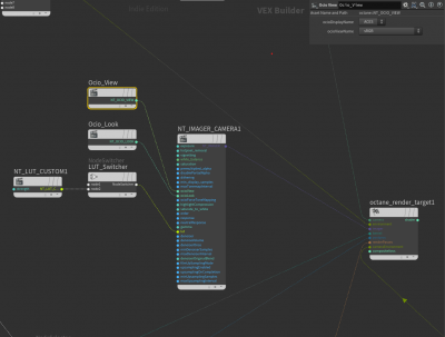

Ok, I believe I've figured this out, enough at least to get a 1:1 ACES representation in the IPR. Here's what I did in case anyone else is trying to figure this out. I implemented this via Houdini, but I'm sure it's the same in other DCCs and or Standalone.

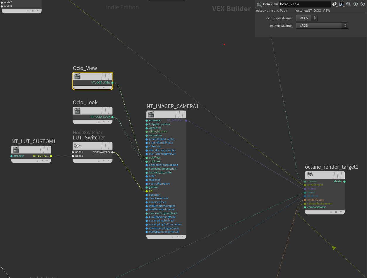

In the Octant Render Target I connected the OCIO View node to the Camera Imager, I also connected the OCIO Look node, but this didn't seem to make any difference. I'm assuming this is a means of saving different look options, but I haven't been able to figure this one out as of yet.. so basically just hook up the OCIO View node (its default settings are ACES/sRGB.

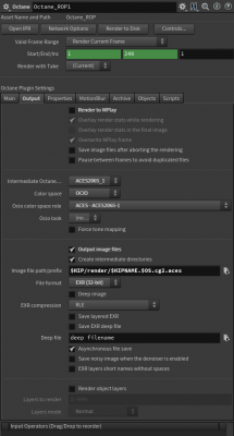

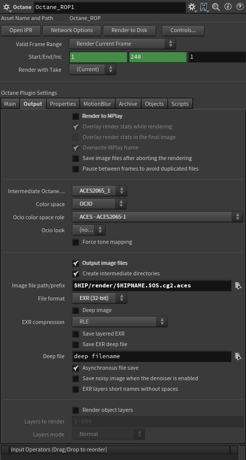

Then in the Octane ROP under the Output tab, set the Intermediate Octane color space drop down to ACES2065_1, the Color space drop down to OCIO and the Ocio color space role drop down to ACES-ACES2065-1.
In this example, the IPR window is on the left and Affinity Photo is on the right showing the ACES exr file.. a perfect match!
View OCIO in IPR 2020.2

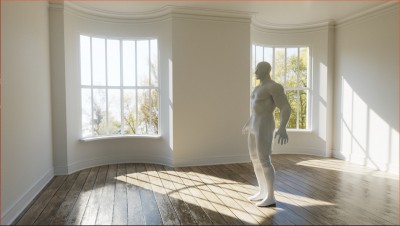

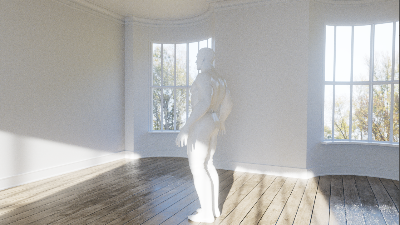

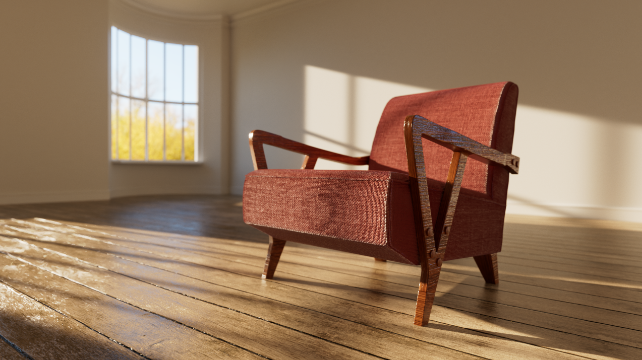

Here's a test render using ACES/OCIO . I really like the treatment of highlights and overall realism of lighting. Very cool.
(I took a screenshot to get this render to disk btw
EDIT: 2 More renders, wow, so much easier to get the lighting/realism right.
Thanks again Travis !

Regarding not being able to save out the image, are you saving the file as an EXR? ACES won't apply to any file format that is natively sRGB, like png.
Also, if you don't have the Color Space setting in the ROP set to OCIO then you can't access the Ocio color space role dropdown and those both seem to be necessary for the IPR to pickup the OCIO view. You should be able to render out with these same settings as long as you're saving as EXR (I use 32bit, but 16 bit will work as well). If you don't have the Color Space option set to OCIO, then the IPR will give you the LUT error. You can change the Ocio color space role in the ROP and if you reload the IPR you will see the resulting change..

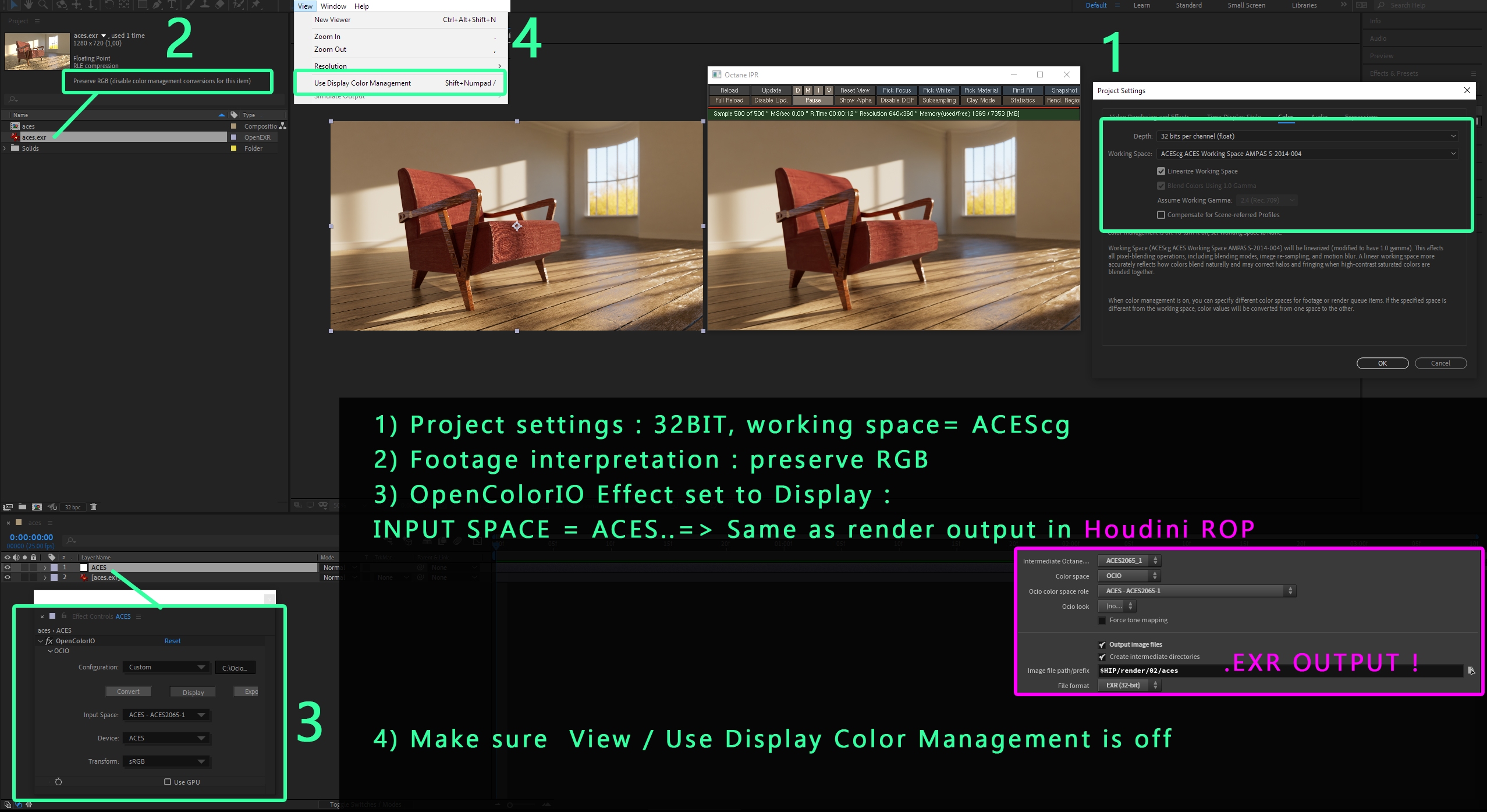

Ok, I got it working in After Effects; this video was super helpful : https://www.youtube.com/watch?v=-QO6t2iR1JI
In the video he adds two adjustments layer, one from Aces2065 to ACEScg, and one from ACEScg to sRGB, that works, but you can just add one, and set it to display like in the screenshot below:
Here's a screenshots if you don't like video tutorials ( like me

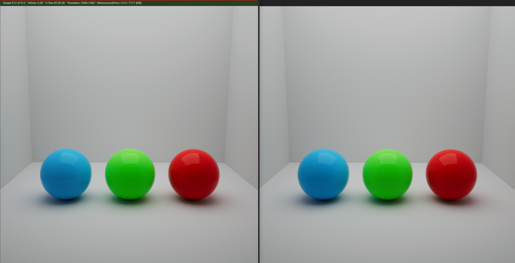

As you can see the colors match between the IPR and the Viewer in After Effects. The banding on the left image is because of the 50% zoom setting in AFX Viewer.
