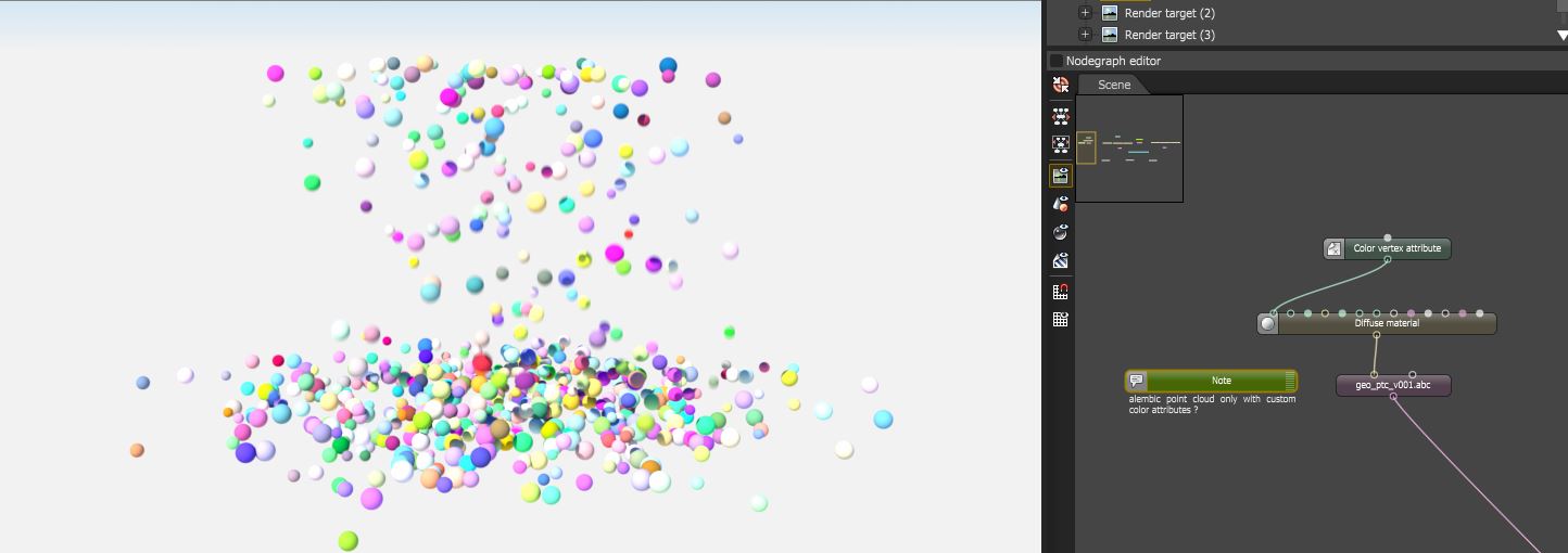

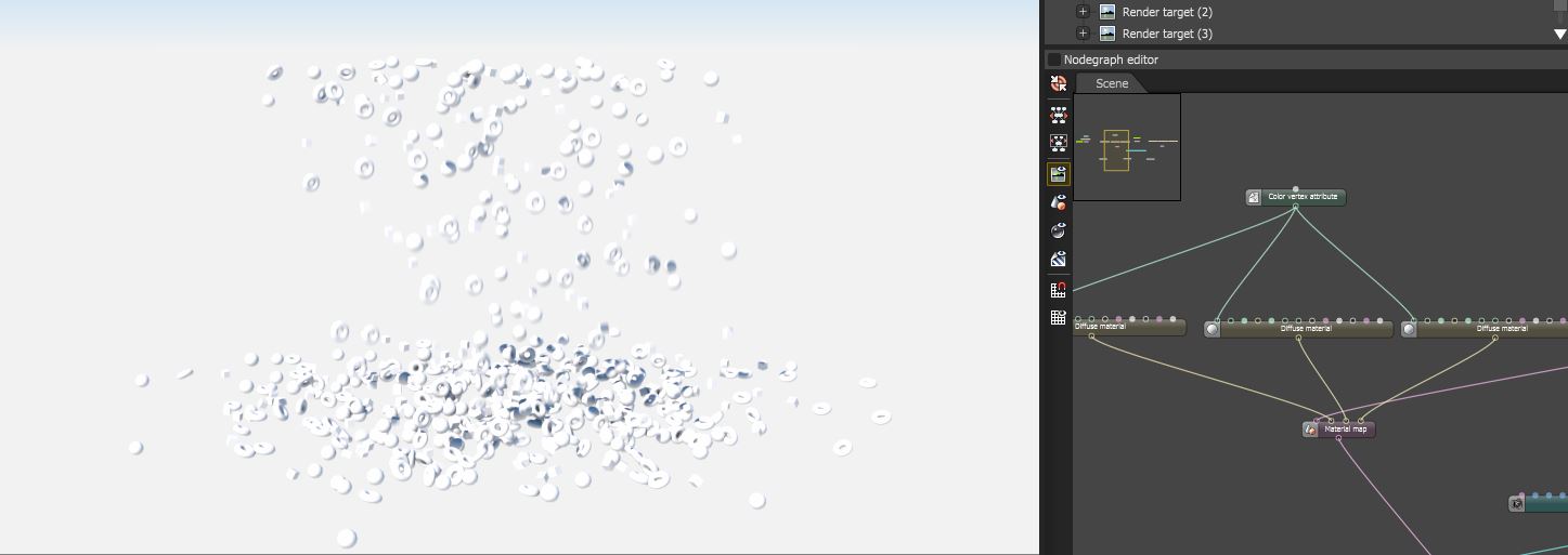

@width and @v are working fine. but i can't find a way to transmit the color of my points to my instance in octane standalone.
Do you guys have any idea on how i can make this work or if it is impossible at the moment ?
i need to transmit these colors:
to these instance.

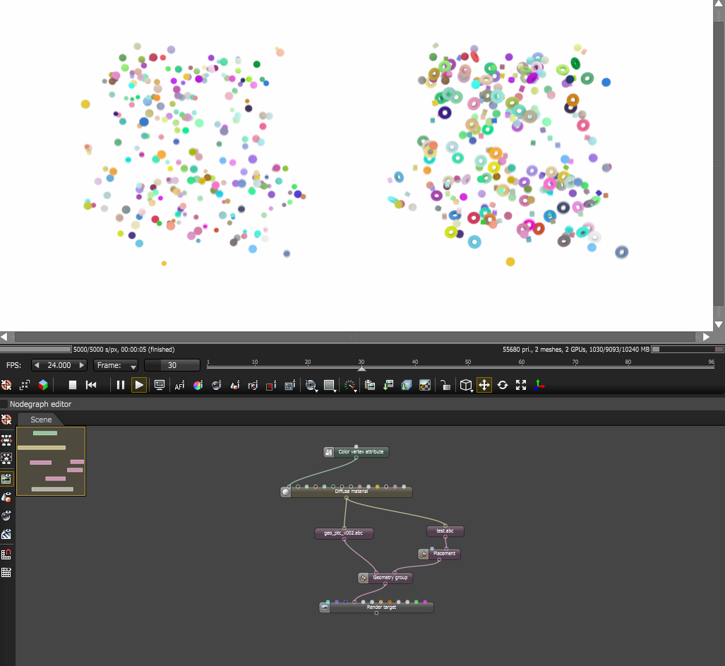

Yes indeed the only way to make this work in standalone is by using the instance color node, loading a per frame custom maps.
I succesfully make this works by exporting a .csv particles sequence and instancing a reference geo with the scatter node. The problem i have with this technic is that :
- i can only scatter one reference object on the point cloud
- i can't have motion blur
I then do some research with alembic to bypass those restriction. Alembic did solve the motion blur problem, as octane understand @velocity on points.
But i am still stuck with colors. You suggest that there might be a way to make the instance color node work also with alembic instance ? for the moment i fail to make it work with abc.
So i might have miss some important info there ?
for ex i have 10 points with random colors and 2 ref object. if i create an attribute ID with integer value 0 for object A and 1 for object B, and if i also create an attribute ID on my points with a value between 0 and 1 to define which object to instance, octane will be able to understand this ? and be able able to match the instance color node , to the coressponding object ?
I know it works in C4D and Houdini, i don't use C4D, but juanjo solve for houdini is working fine, but i prefer to assemble my scene in standalone to be able to render on the cloud.

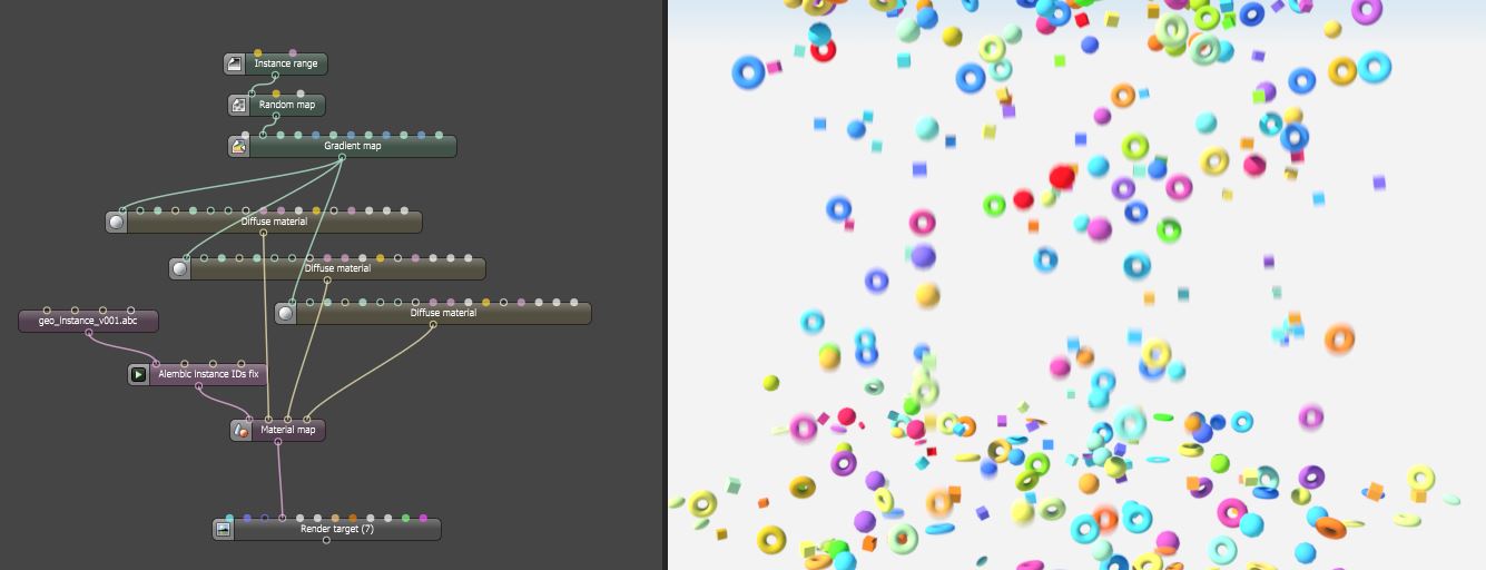

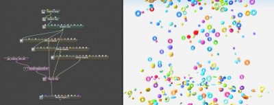

Hi Fantome,
I took another look into this.
Although I'm still not sure where exactly the issue is coming from, I think the core issue is in the way Octane sees the Alembic file, for one reason or another. The one called "geo_instance_v001.abc" which has the different reference objects and the motion blur. Instances are sharing the geometry references but they don't have IDs, so we can't use any instance based shading. I don't know if the issue is on the export side or the import side.
However if we go through the instances and force a unique ID on them, it should enable per-instance shading. I wrote a (very experimental) script that makes a copy of the input alembic and add the IDs. It seems to work, I can use the "Instance range" node to generate a unique color per instance.
I don't know if you will be able to transfer the "Cd" attribute directly, you'll probably need to generate or have Houdini generate the instance color map for use with the Instance color node. For this you'll need to know how the IDs are generated: I just incremented the ID for each found instance, irrespective of the source object. The counter does not reset for each reference object.
The script graph exposes pins for the materials but don't use them, they are only there to force the Material map to create its inputs.
I attach the scene with the scriptgraph inside, let me know if this works.
