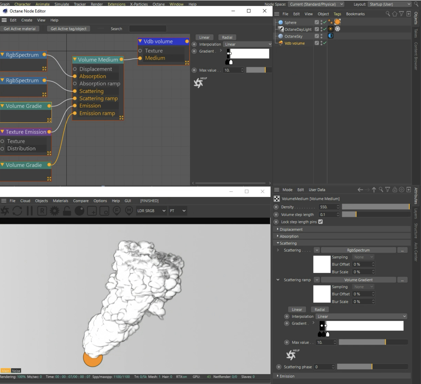

Im rendering out a vdb sequence in C4D and the rendertimes are crazy and I cant seem to fin a Volume Ramp in C4D octane like Houdini has to speed up the rendering. ( So octane doesnt calculate allt the voxel data, but only the visible ones ).
Hope this question makes sense
Posts: 10575
in c4doctane, the Volume Ramp is called Volume Gradient node:
ciao Beppe
eldvatn
Posts: 9
Joined: Fri May 29, 2015 8:47 am
Great thankyou Beppe!
