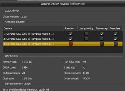

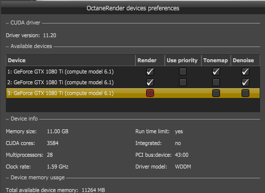

Enterprise 2020.1.5-R4 Standalone and Plugin. C4D plugin refuses to let me enable this 3rd card. Have tried disabling the other cards, updated studio drivers, cleared prefs. Problem exists on r20 and r23. Octane Standalone happily has all 3 cards enabled. Any ideas?
Can only enable 2/3 cards in C4D
Be sure you've installed Enterprise edition and have enterprise license
