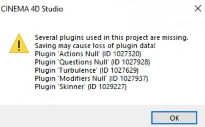

I have tried with your scene, but I have a missing plugin, and the VDB file is missing: Anyway, please try with the following version and report back: All the MoGraph cloners didn’t have the render Instance option active, and I have disabled the Subdivision object, and enabled the same option into the Octane Object tag, to apply the subdivision only at render time.

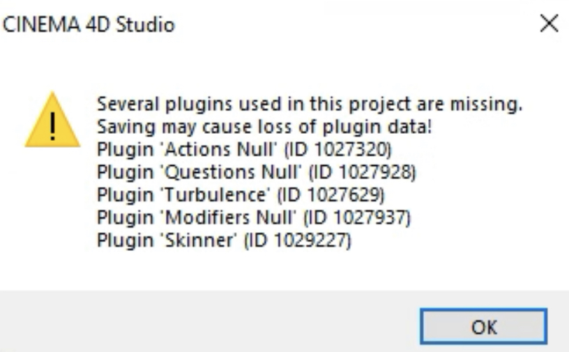

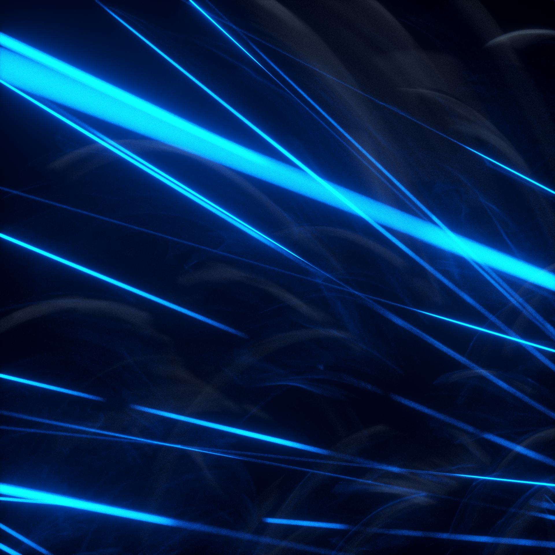

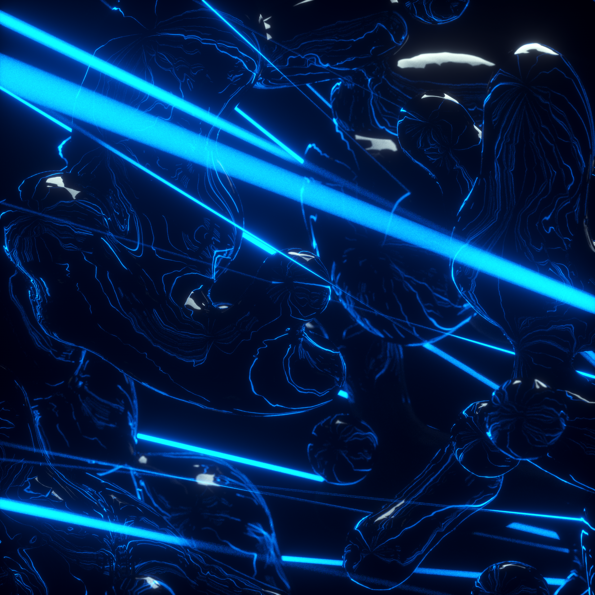

I ran the render again last night... no crashes however the skinner object under the octane object tag rendered for frame 1 then the remaining frames it looks like its only rendered the motion blur or something. See attached images...

Great to hear that it is working again also for you
About Motion blur issue, have you tried to reduce the Shutter speed in the camera tag, it seems pretty high now
