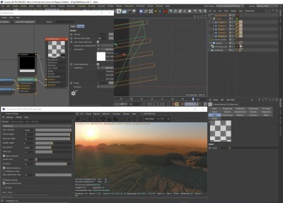

Hi Frank,
I have tried with one of my scenes made with the same technique, and everything seems to work as expected here in 2020.2-RC6:
What kind of issues are you having exactly?
