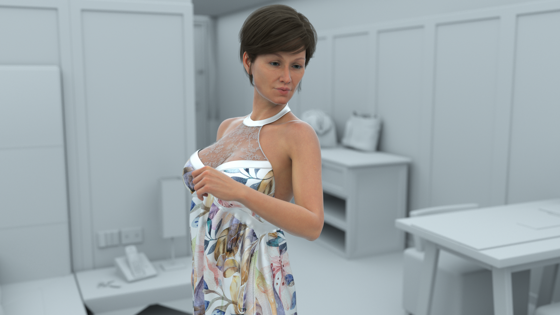

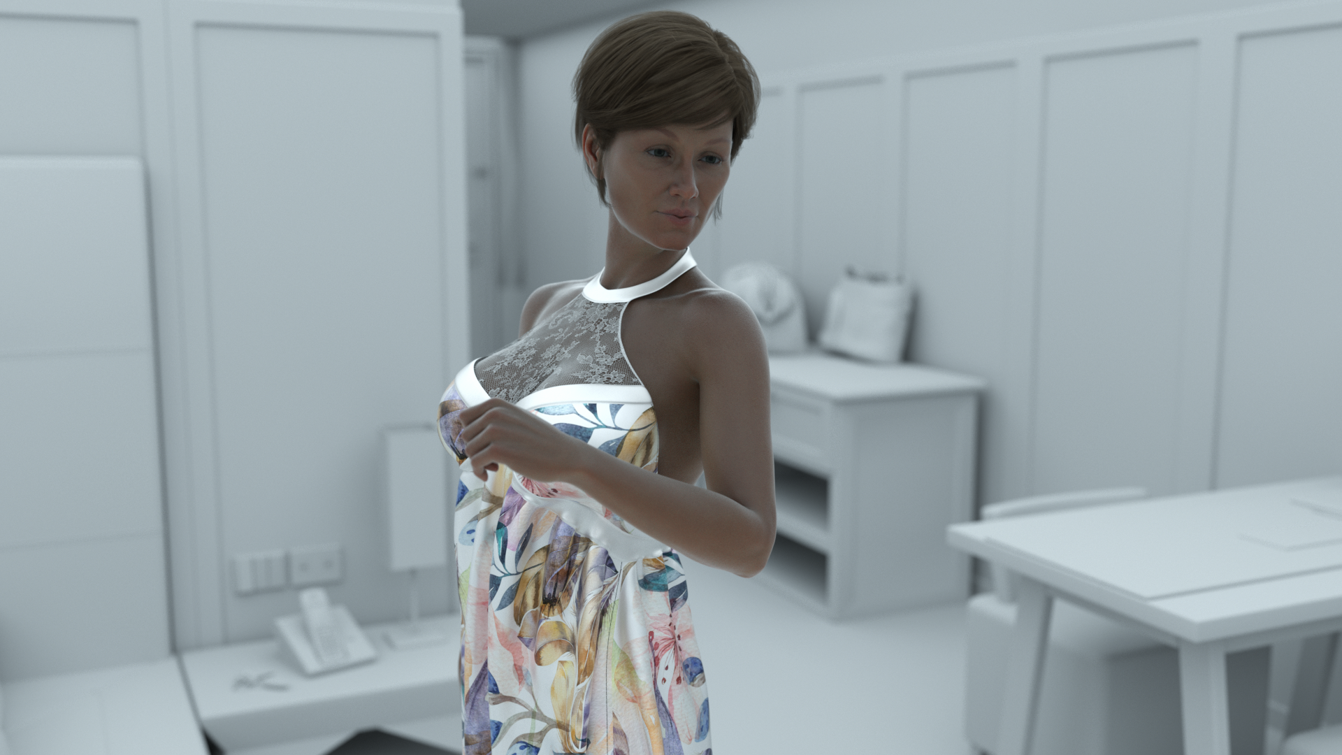

I am encountering a strange problem when working with random walk/specular material. Here is a scene in which the model is inside a room which has only 1 big light plane right under the ceiling. There is a second light plane outside the room, it does not effect the interior since it faces away from the room and I dont have a material applied to the window glass. The problem is, when i turn on this second emitter, the skin gets really really dark. It reminds me of when i turn of fake shadow in the specular material.
Here is a picture of the scene when the second (outside of the interior) emitter is turned off, everything is normal:
And here is how the skin looks like when i turn on the emitter:
Notice that only the skin (specular material with random walk medium) is effected. I tried using diffuse and glossy materials for the skin and this problem does not arise.

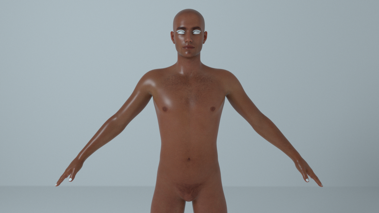

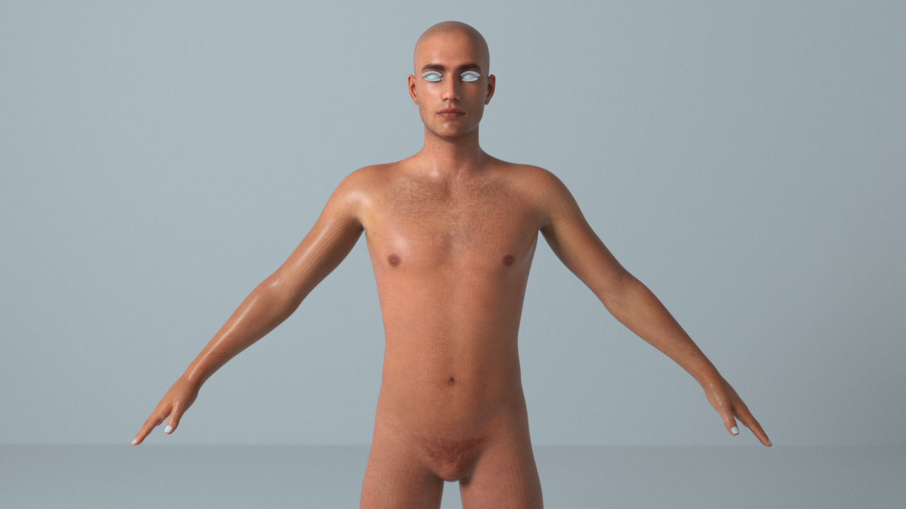

I created a way simpler scene to test this again. I have a Genesis 8 Base Figure from DAZ inside a closed cube primitive. This figure has a specular material + random walk medium applied.
The characters is lighted with a single plane-emitter inside the cube. Now I add another plane-emitter outside the closed cube. The skin immediately becomes dark when I turn on the emitter outside. That is the problem in a nutshell. I dont know why this is happening still.
Skin looks normal without the emitter outside:
Skin looks dark with the emitter outside:

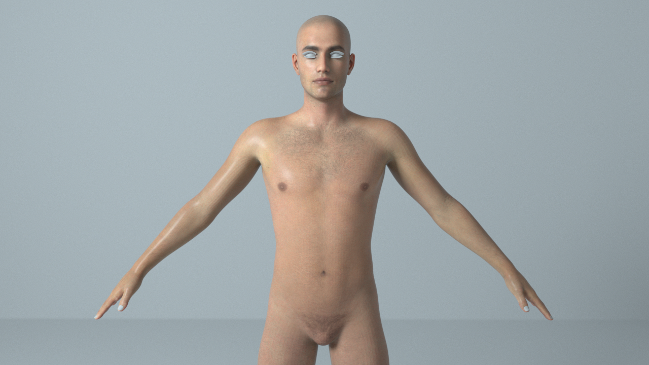

As far as I am aware, fake shadows always needs to be enabled on specular material if you want to use it as skin material. Fake shadows are enabled in both pictures, I did not change the skin material at all, which is exactly the problem. But I agree, when I turn on the second emitter (outside of the cube) the look of the skin then reminds me of when fake shadows are turned off. But that shouldn happen (since I didnt turn it off obviously). I guess it has to be a bug at this point.
This is how the skin look with fake shadows disabled and the outside emitter is off:
And with the outside emitter on:
Its barely noticable but the skin still becomes darker ever so slightly, and it shoulnd't because the cube is completely closed, and why would it become darker anyway, I dont get whats going on...

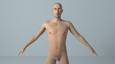

Banti wrote:I created a way simpler scene to test this again. I have a Genesis 8 Base Figure from DAZ inside a closed cube primitive. This figure has a specular material + random walk medium applied.
Here is the small text scene orbx:
https://www.mediafire.com/file/d8ztsi1a ... .orbx/file
I really hope someone can help here.
