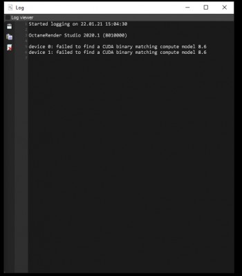

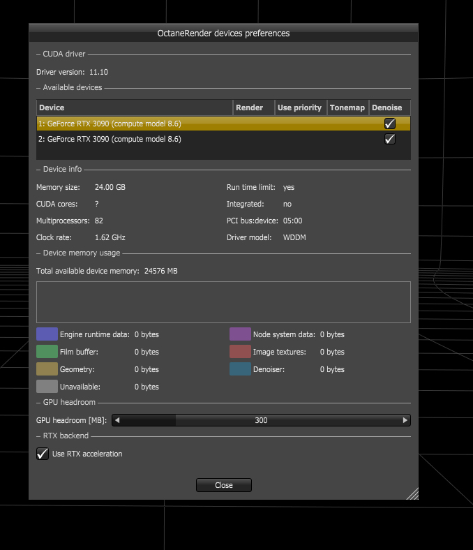

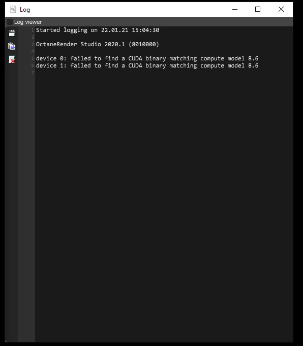

So i have bought a new computer, with 2x nvidia 3090 and im trying a newest Octane 2020.1 and when i try to render a scene all i get is this...
What should I do? I HAVE to work and render its my work i cant have days when i cant use my computer for rendeing... :(

Ok solved, updated drivers, and found on the forums in the poser Octane 2020 sticky thread link to 2020.1.5.104 its not in the downloads page you guys might wanna fix that
i wasted half a day on this shit...
