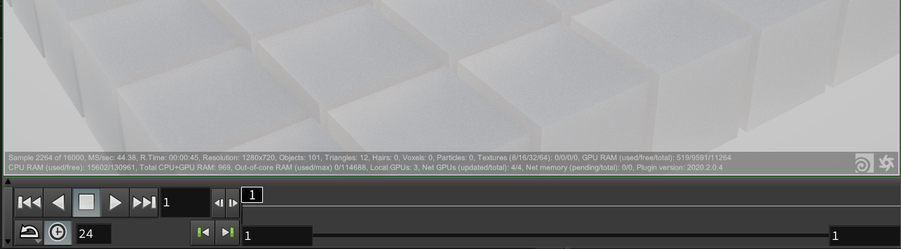

Hey Juanjo,
Thanks for replying!
Unfortunately, setting the slaves from the standalone interface didn't work. I also tried to create an Octane ROP in the scene from where the PDG graph is executed and then set the network options from there but it didn't work either.
It seems that it happens on a per-session basis as I noticed that I have to steal back the slaves everytime I launch a new Houdini.
If you have any solution, that would save me a lot of time! We can't afford the Engine licenses for the render farm and I did try Hqueue on a single machine but couldn't figure how to make it work.
Thanks for your time,
Ben
