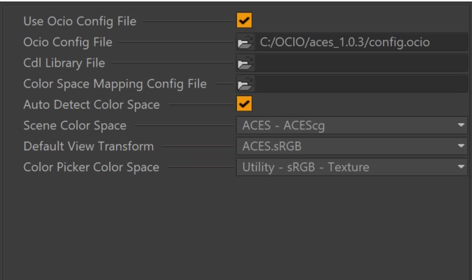

I think we should need a viewer lut... which we would put ACES->SRGB to be able to view it properly in our srgb moonitors.. or ACES->REC709, etc...
I attach here how simple it is in Clarisse.
thanks!
