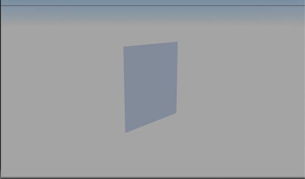

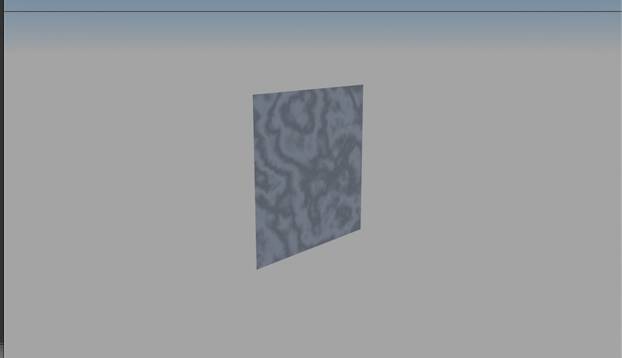

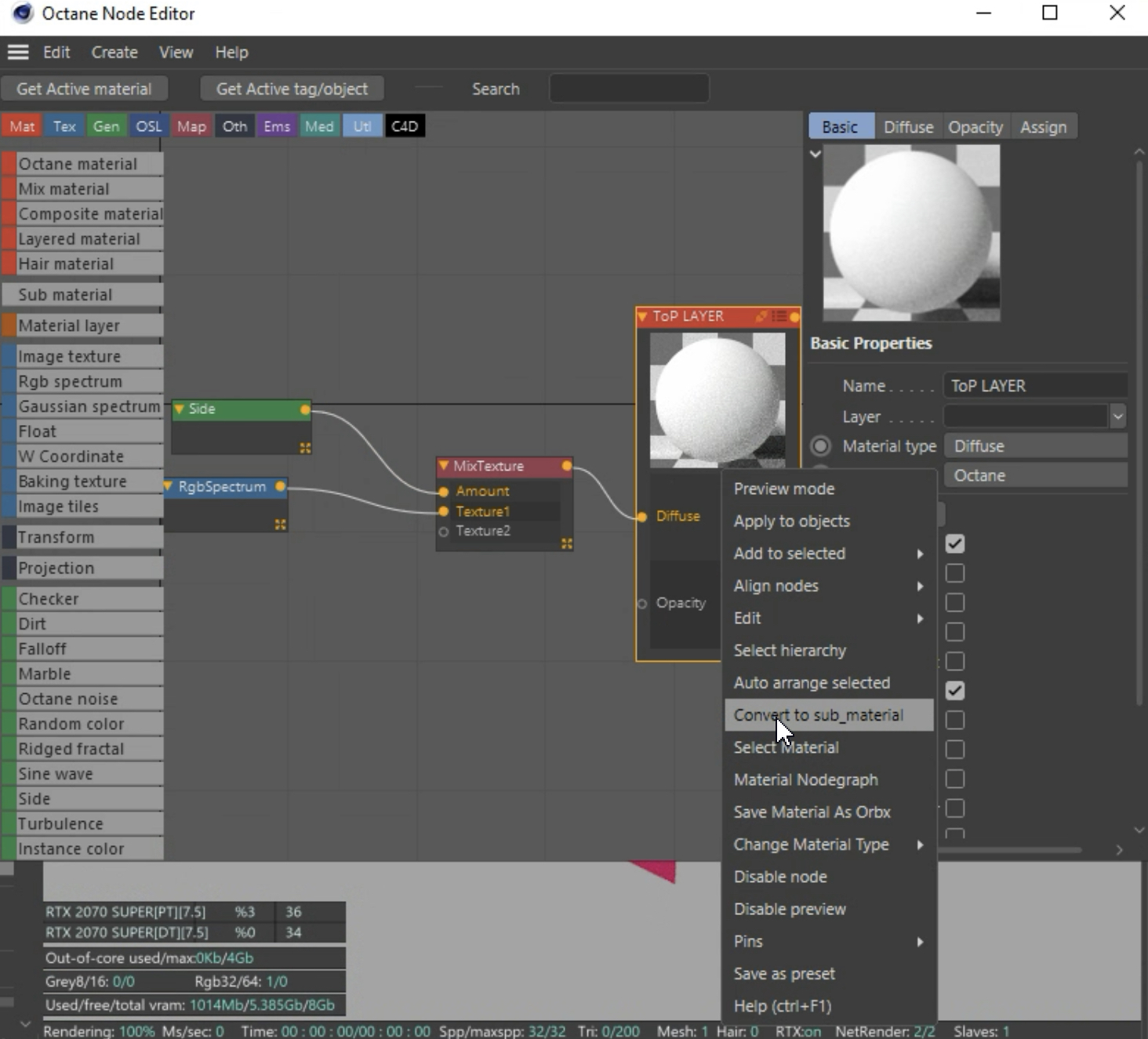

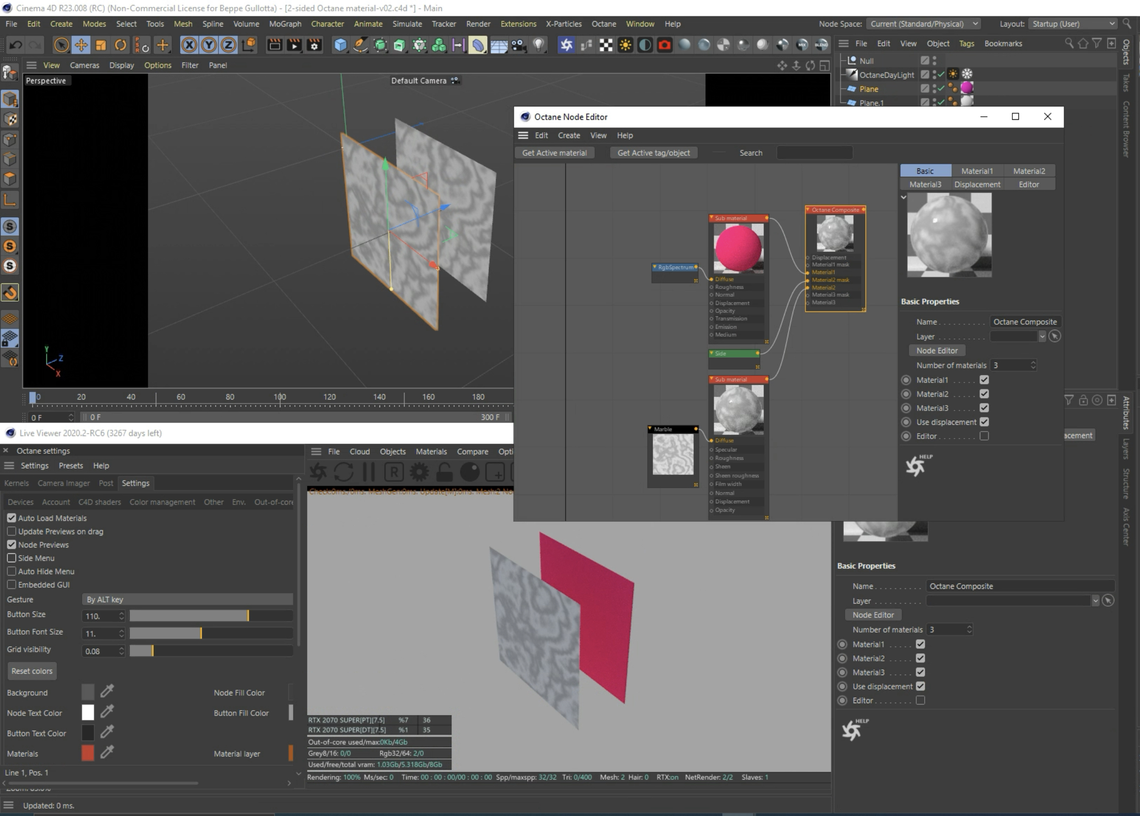

I'm trying to project a material on one side of a plane, with another on the back
I know I can do this using the Side node and Mix Texture mode (following Octane's documentation), but I want to use a base layer, with the front side on top of it
Screenshot 2021-01-20 at 22.16.46_70.jpg (4.75 KiB) Viewed 1112 times
Screenshot 2021-01-20 at 22.17.19_70.jpg (2.42 KiB) Viewed 1112 times

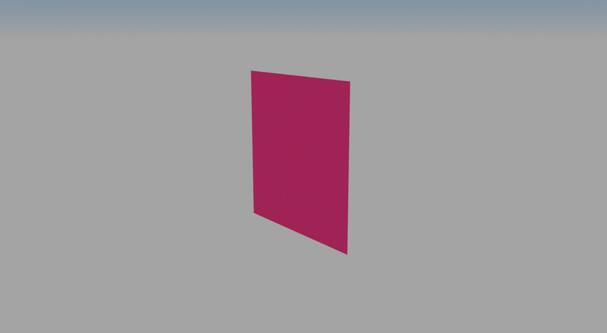

It produces a blank back to the plane:
Screenshot 2021-01-20 at 22.17.05_70.jpg (4.34 KiB) Viewed 1112 times

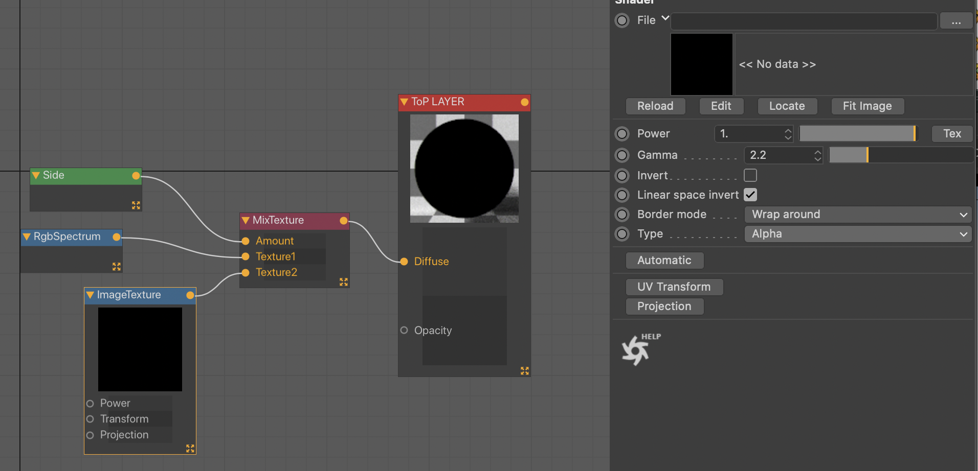

Is there a way round this? I've tried to use an imageTexture node with alpha set, but that didn't work either:
I've attached my C4D file in case anyone wants to take a look
2-sided Octane material-v02.c4d.zip
(76.65 KiB) Downloaded 100 times

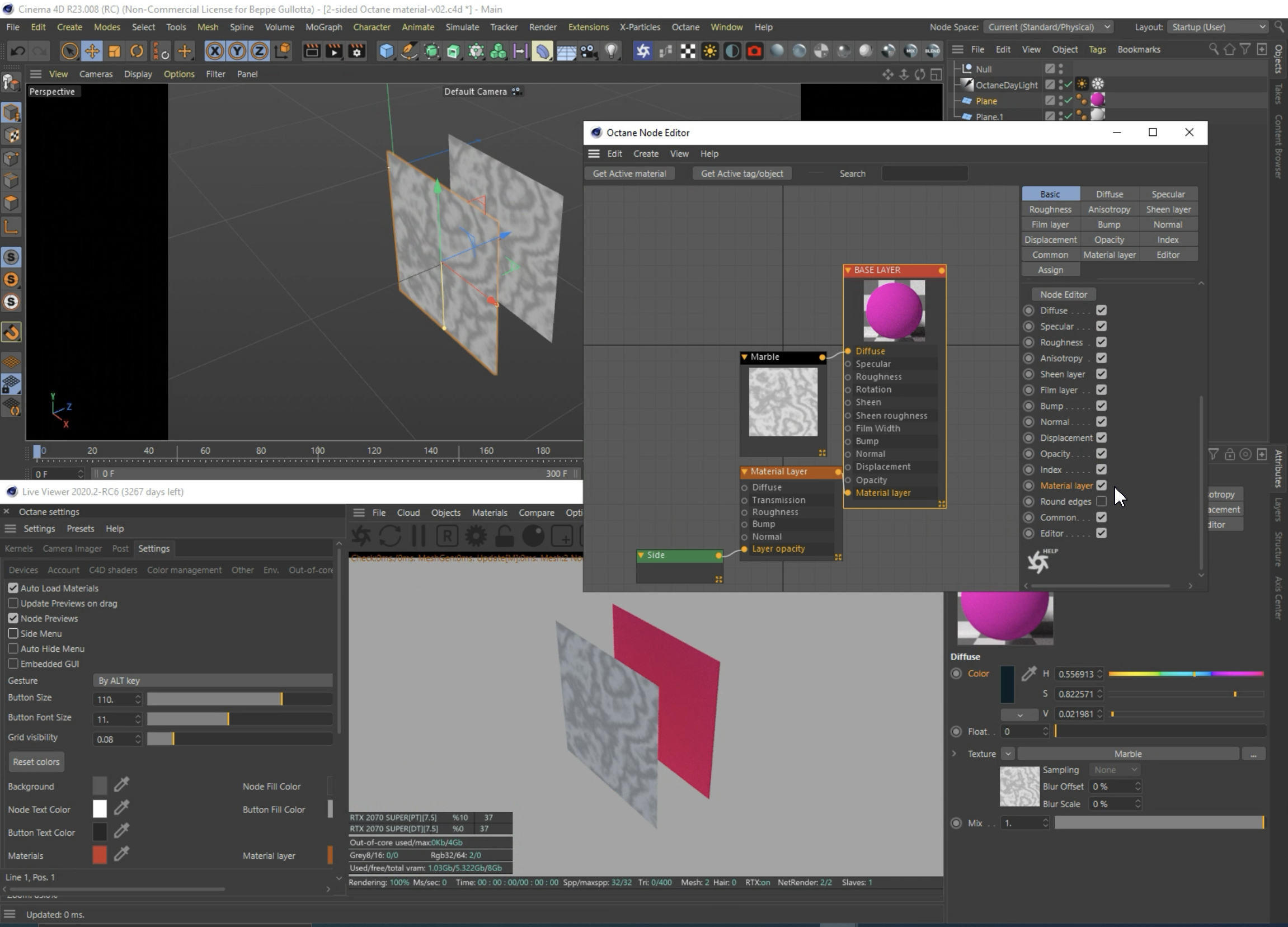

Posts: 10621
you are working with two different materials :roll:
There are two ways:
1. Transform both materials into submaterials:
then copy one of the in the other one and connect the submaterial to the new Composite material created, using the Side node in the Mask:
2. Add a Diffuse Layer to one of the material, and use the Side node in the Mask:
Here is the scene, on the left the Composite Material version, on the right the Layered Material version:
2-sided Octane material-v02_b.zip
(57.74 KiB) Downloaded 108 times
ciao Beppe

Finally got Octane running again - Side node on the opacity worked a treat! thanks
