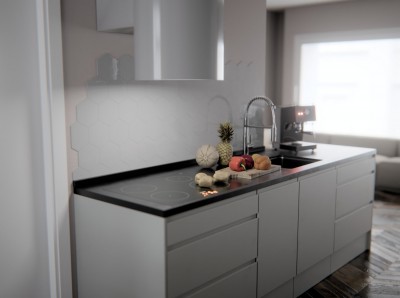

KITCHEN SCENE
Hi, hi mean in terms of speed, i looked in the web and in the forum and i hoped the lights portals could be my friend but the only way i found for have a clean image was 35.000 samples and a lot of time, i like the look of the render in octane and the dof, but there is some problem , octane miss some node for the foam in ocean modifier, and the caustics is not so specials, i was a vray for blender user, i bought a license so many year ago, but chaos seems not intetioned to develope again.
Therefore: nothing to complain about the quality, but the speed in the interior seems a problem to me, perhaps because I'm not an expert in Octane, ok there is the denoiser, but too massive use makes the images fake:

marko, what kernel settings are you using? Try setting gi clamp to about 500.
35k samples is a bit too much for a relative simple scene like that.

i saw a tutorial in the web , i set the GI clamp to 1 and i use an HDRI, fake shadows in the glass,filter size default, adaptive sampling, i have in my plane to buy an rtx 3090 but my question is :it's normal it's needed 35000 samples for a clean image without denoising?
