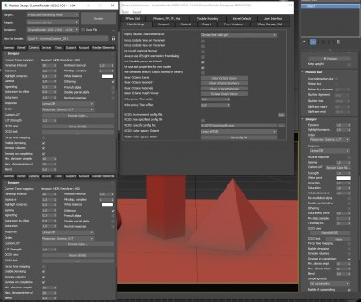

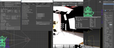

Hi..
it's clamping pixels above 1. If you render and right click over the pic where you have something blown in intensity.. you should be able to see values above 1. Try it.
They don't show in 2020.2 . I can only see values going from 0 to around 1.
In 2002.1.5... to get not clamped renders... i changed current tone mapping from HDR to HDRI lineal in kernel tab and it worked perfectly.. But now in kernel tab in this version 2002.2 those options are gone!!!..
now it says HDR and HDR half..(instead of HDR and HDR lineal) why? i don't know why that changed.
I have the same settings...as yours...
What's your kernel settings? I have not setup OCIO yet...
kind regards,
Javier
kind regards,
Javier

Well..
after a paride post i found out the issue. I think it's a bug:
=> pixels are clamped over 1 in the render buffer of 3dsmax, when OCIO is turned off / disabled / or no config file
(this should not happen..)
=> when Ocio is setup properly... the pixels are not clamped (unless you put srgb in OCIO color space)
I know the hard stuff that AcesCG / OCIO setup is..when 3dsmax is not even prepared for that yet..
i have been strungling with that in Nuke, After and clarisse...
and as 3dsmax is like delayed with all this.. i could set it up in Vray.. and now i have to find the workflow in Octane to make all match..
Thanks for putting OCIO and AcesCG here... as AcesCG is the way to go to make all more realistic renders..
