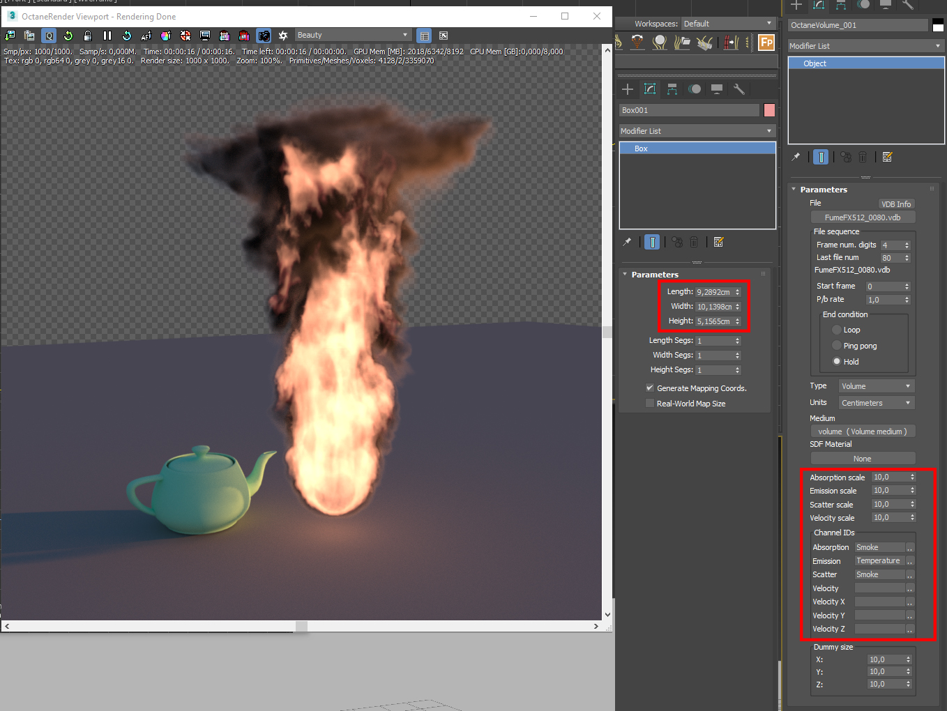

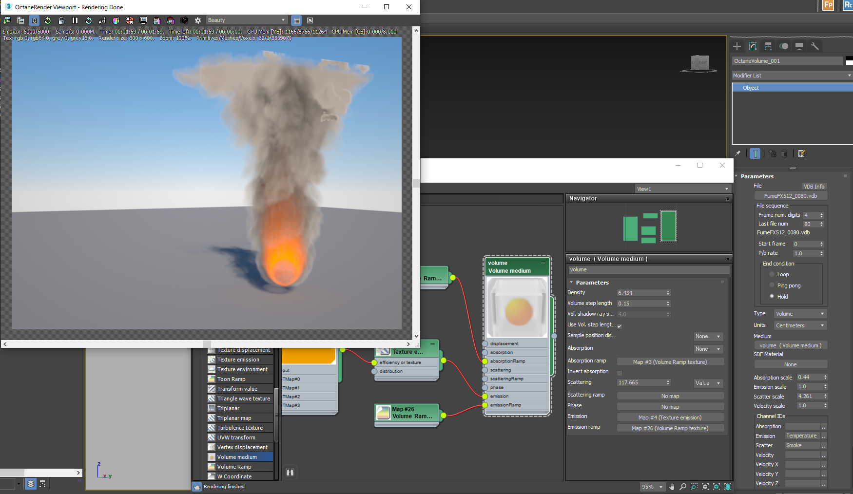

Hi patis,
there are some important elements to consider when rendering your scene: the unit of measurement of the scene, the scale vdb volume medium and Channel IDs.
Regards

patis
Posts: 11
Joined: Tue Mar 17, 2020 4:28 am
Thank you sir, It works well :)
