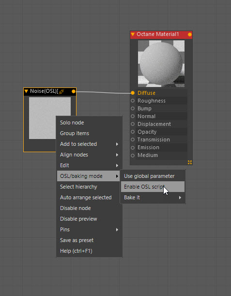

Other than this you can force to choose an exact mode for each node, from the node editor. See picture

Have you set the osl usage from the nodes for testing? It shouldn't take care of what's the global settings so
