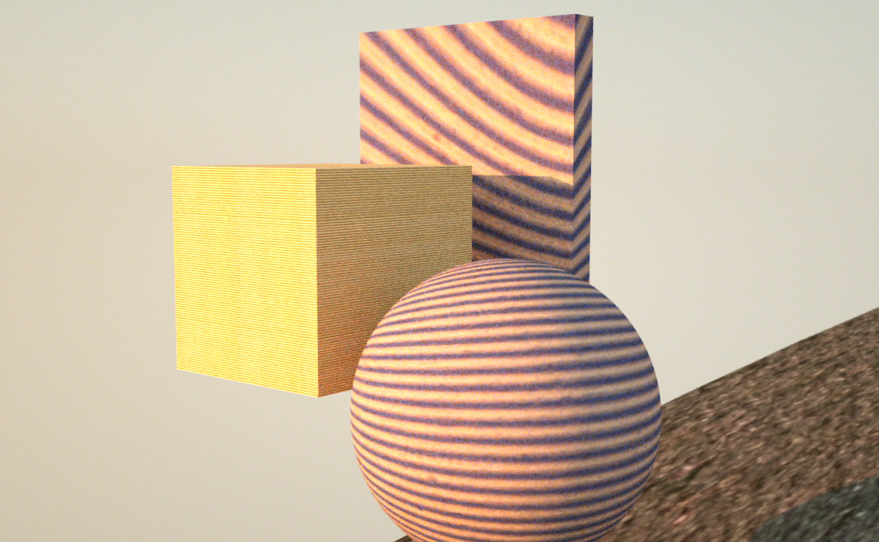

half and half cardboard and colour

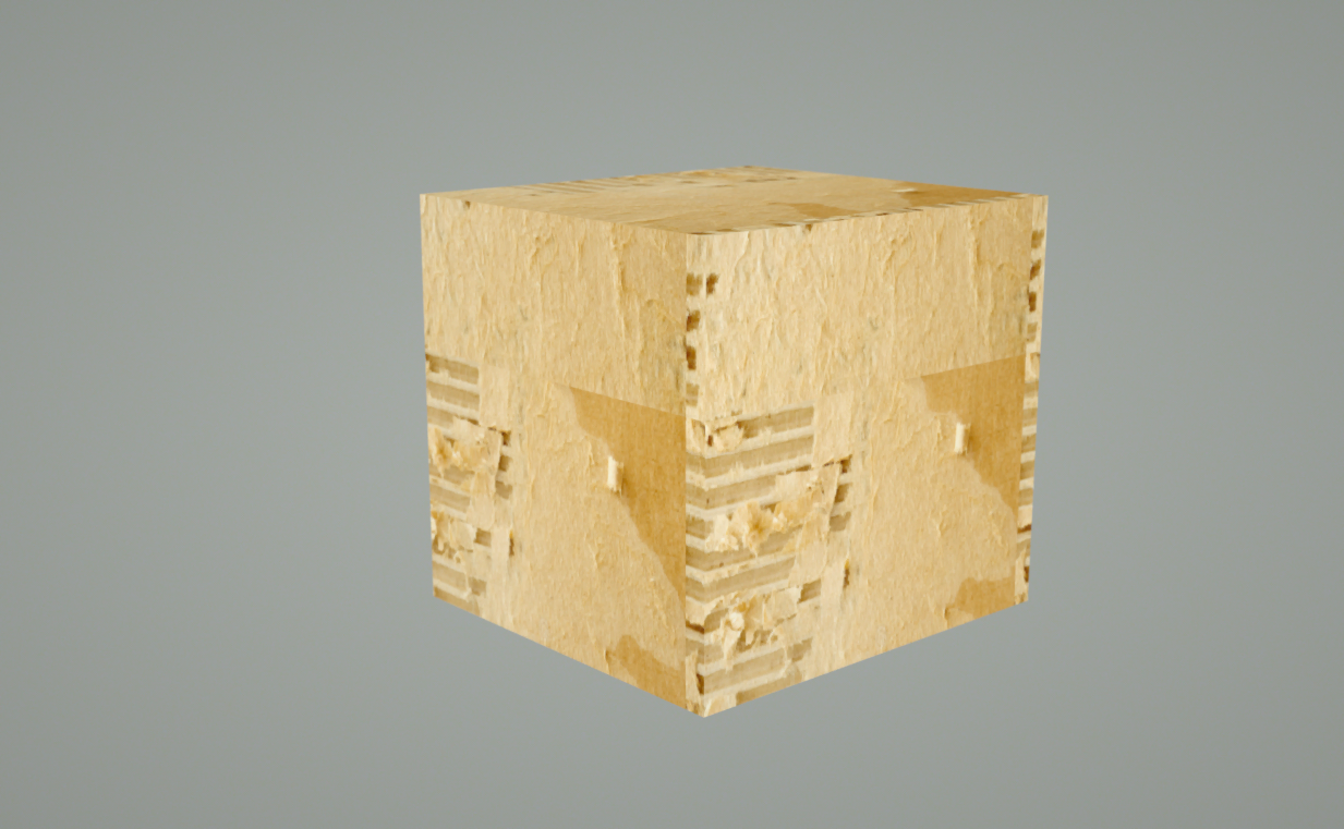

want to add colour to this

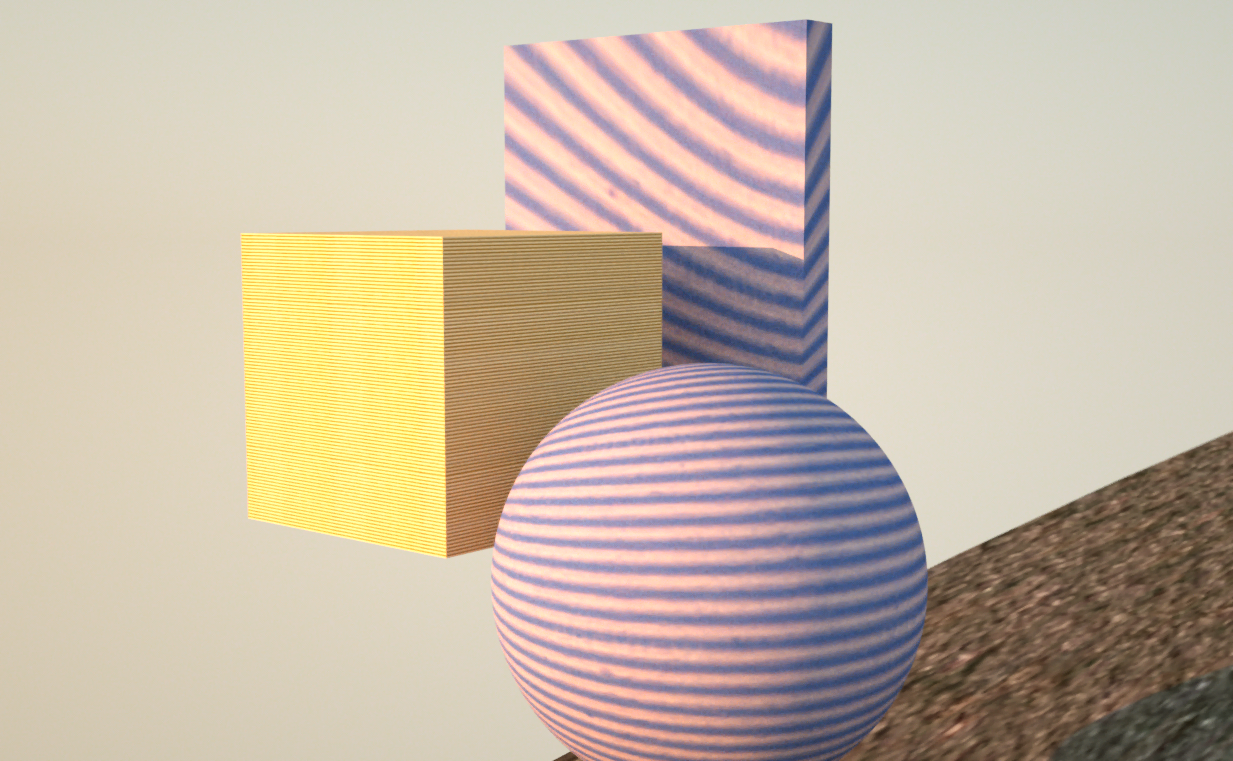

pure cardboard image

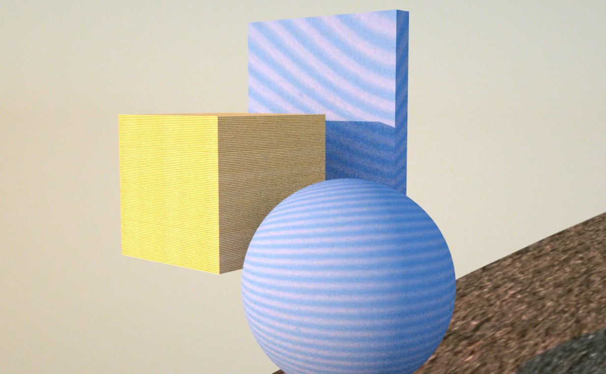

cardboard image is fading when blue increased
