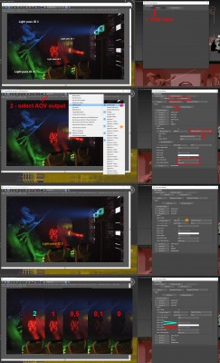

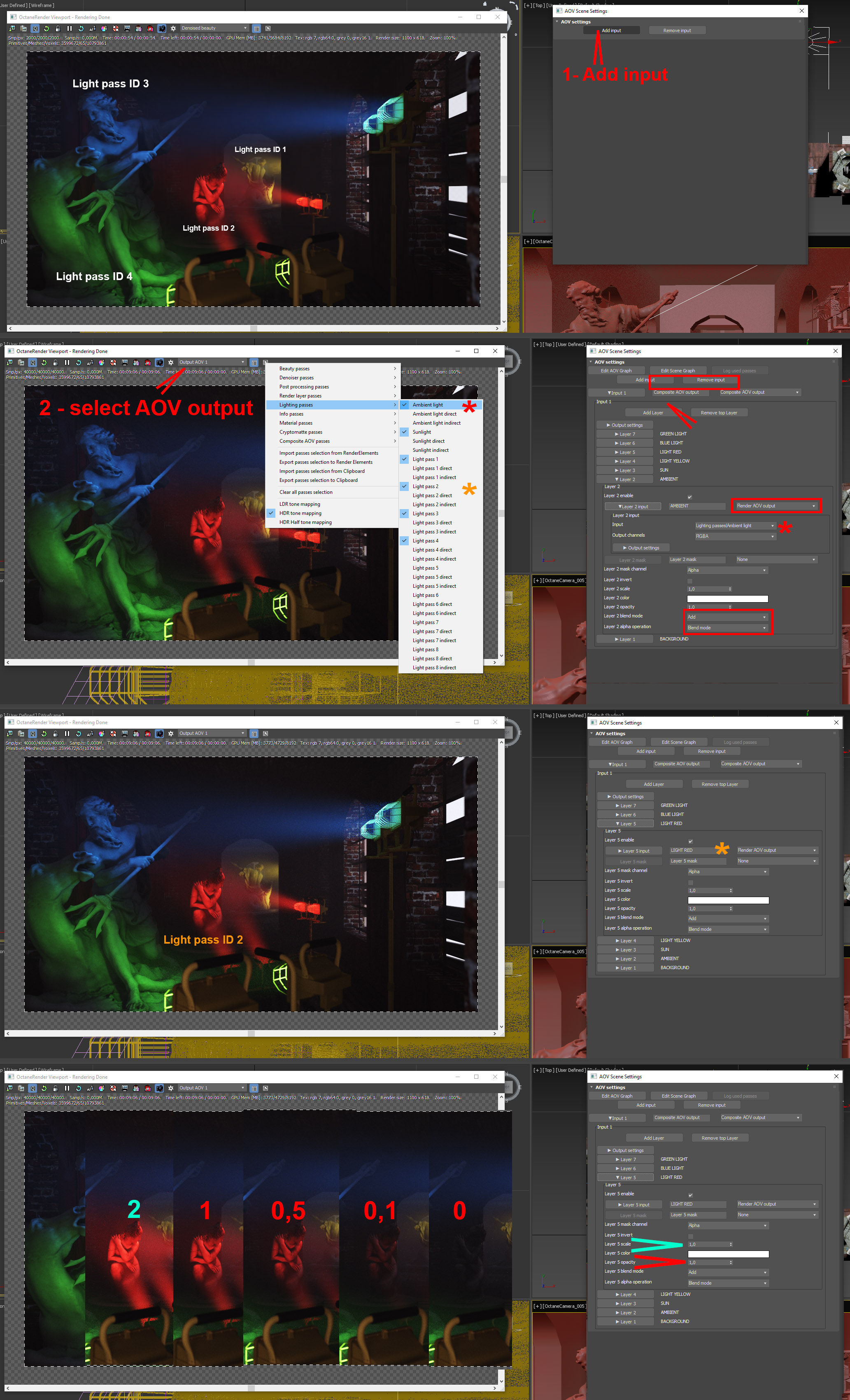

Hi guys,
Light mix using AOV (v2020.2).
Regards
Paride

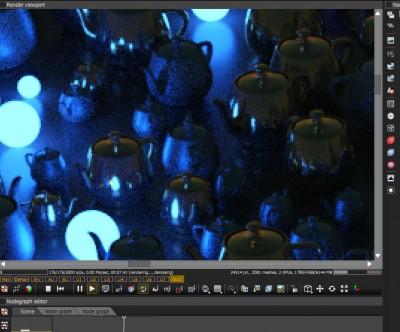

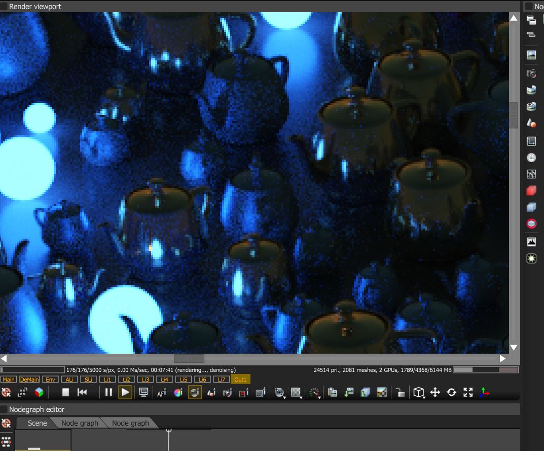

Getting there :) , I`m able to get the lights tuned right, but I can`t get the Denoiser to affect the Out1 pass, is that a limitation? Or did I miss something?
