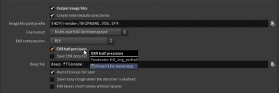

By default, the Houdini plugin EXR files are always 32bit, but the option to export half precision EXR files is available if you enable the "EXR half precision" option.
Hope it helps,

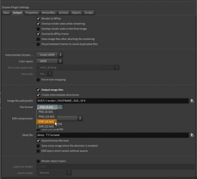

In any case, in Octane 2020.2 all the export options have been updated to fully support the new Octane features, so on it, you are going to be able to select directly the file format and the precision using a single option, as you can see in the attached image.
Thanks,
