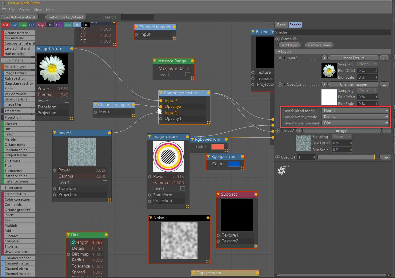

Mitchino, if you are referring to a Photoshop layers style blending of images, that will be available in Octane 2020.2, I was just playing around with the 2020.2-RC5 (Release candicate) from 23.12.2020 today, and there is a Utility Node called Composite Texture. I'm really looking forward to that in a production ready stable release.

So I've installed 2020.2 RC5 and I have access to new nodes including composite texture. How do I use it? I thought I would see a drop down menu in the node with Multiply, Screen, Overlay, Soft Light etc etc?
Just don't understand what this node is supposed to do?

mitchino wrote:So I've installed 2020.2 RC5 and I have access to new nodes including composite texture. How do I use it? I thought I would see a drop down menu in the node with Multiply, Screen, Overlay, Soft Light etc etc?
I'm attaching a test file with a super simple example of a checker pattern layer on top of a simple color layer.
The dropdown menus with different blend modes have for me somewhat confusing defaults in the C4D Octane plugin, so I checked out the Standalone RC5, which had more predictable default settings. Those are in the "Composite Texture Octane Standalone Defaults" material.
All that will surely be made more clear when we have documentation for all the options, but with the settings from Standalone you can use the opacity slider and Blend Mode dropdown as you would in Photoshop.
