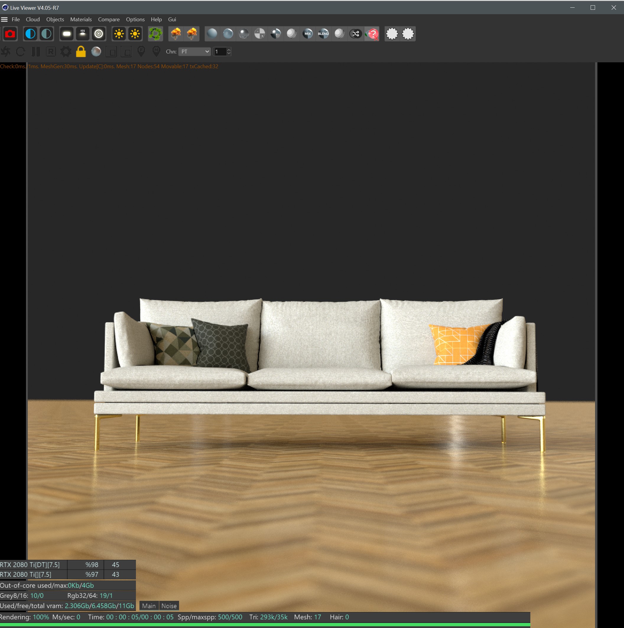

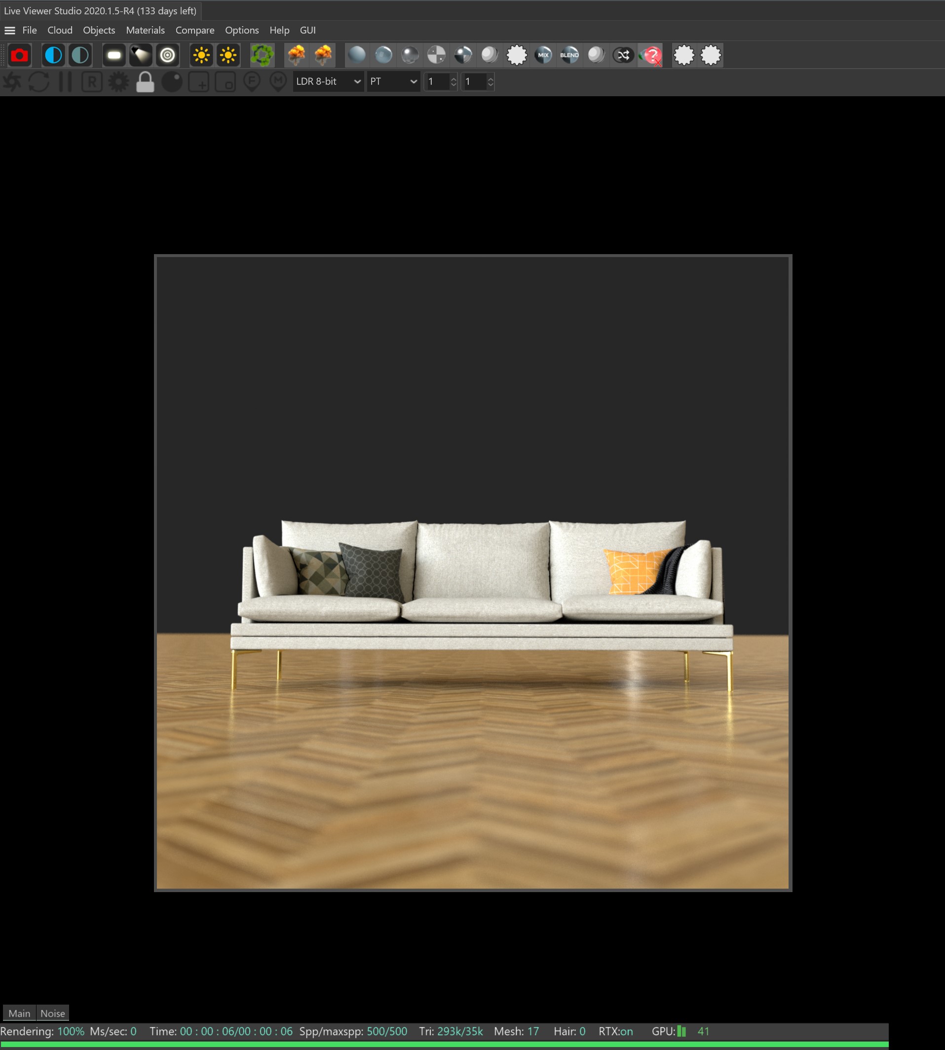

Ok, i export my scene and open Standalone 2020 and 4.05,
in 2020.1 Standalone i get 6 sec. score, and in 4.05 Standalone also 6 sec. nothings change.
But in R21 4.05 i figure it out something wrong resolution lock/unlock feature.
Lock/Unlock doesn't work? it doesn't affect LV. Lock or unlock i get same resolution but somehow looks big and drops quality? (in attachments)
2020Stable lock/unlock feature working well but look small in LV as it's supposed to be :)
That's my research :)
Thanks.

2020 has desktop scaling support. What you see for sizes are correct now, v4 was not supporting that.
