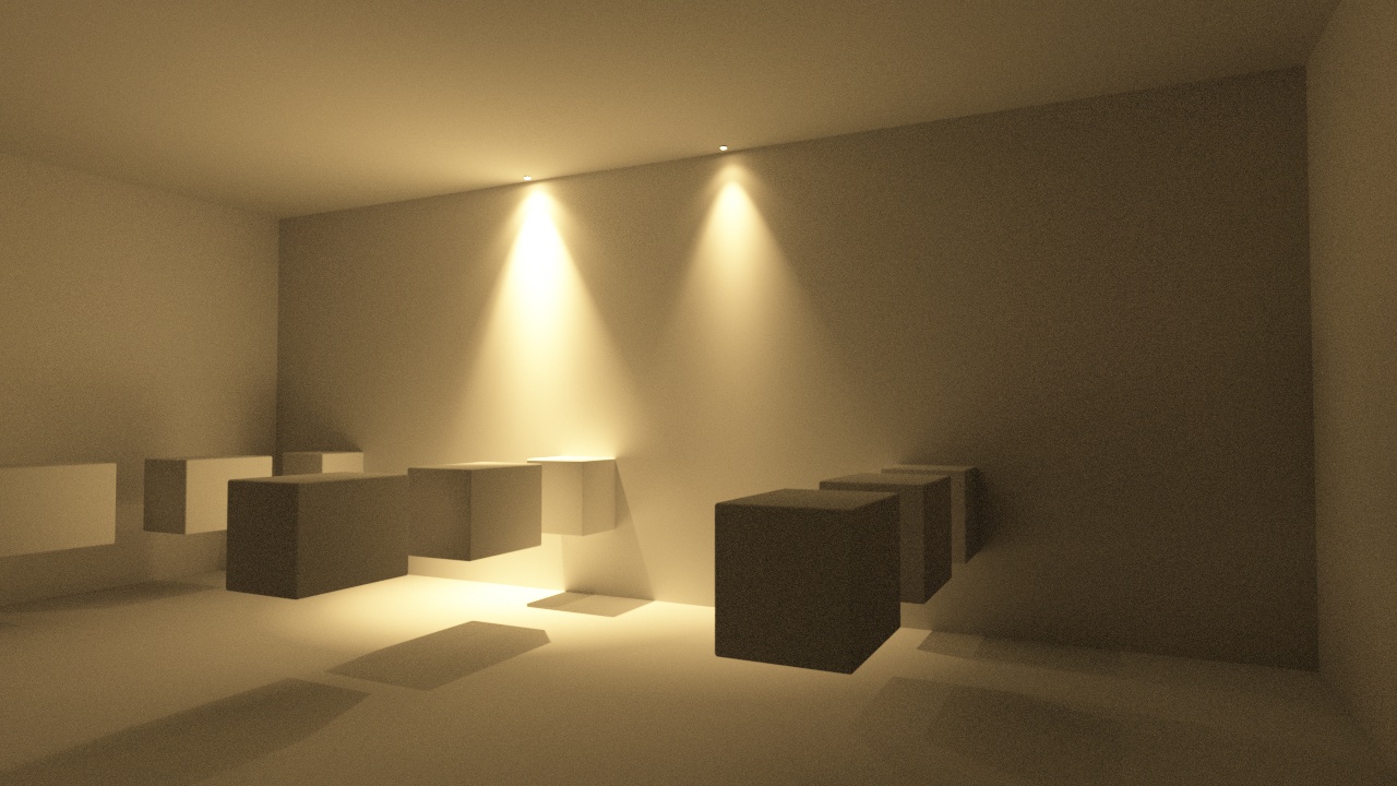

The attached image and file illustrate the issues.
The light on the right has a value of 8.6 watts. The light on the left has a value of 60 watts. If the left light is supposedly a halogen/filament light and the light on the right an LED light, they should be of similar 'brightness', so how do you tell Octane that?
The c4d file also has some lights with correct values for the LED light as calculated using the info from bepeg4d - many thanks!

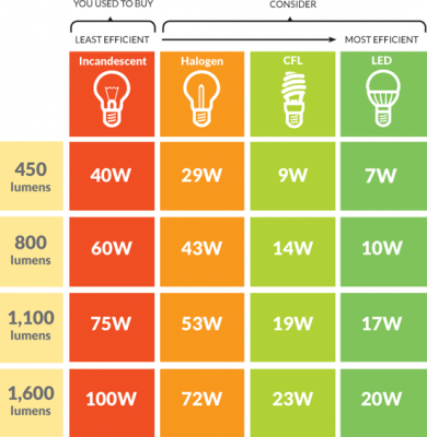

Regarding lights of different types, halogen vs. LED in your example, you need to look at the actual illumination output, as you know, moreso than the wattage. I find this chart helpful:
It is from this website: https://www.homelectrical.com/cfls-vs-h ... led.6.html
The user interface is very general in regard to situations like this. Fortunately, you can dial in the settings as required (setting color temperature, for example) and use information such as that in the referenced chart to balance out the results. There is plenty of information online for lighting fixtures that can be used effectively within Octane.
Obviously the lumens are different per watt of the various lighting technologies. Since we are dealing with watts in Octane, I would use the equivalent lighting information. In other words, if an LED light of 20W produces a practical out of 100W (not 20W), then use 100 for the power value and adjust the color value for the LED.
