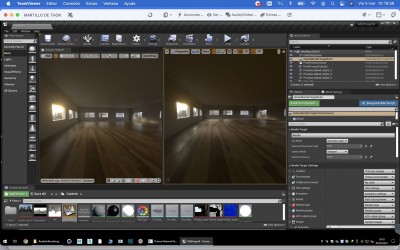

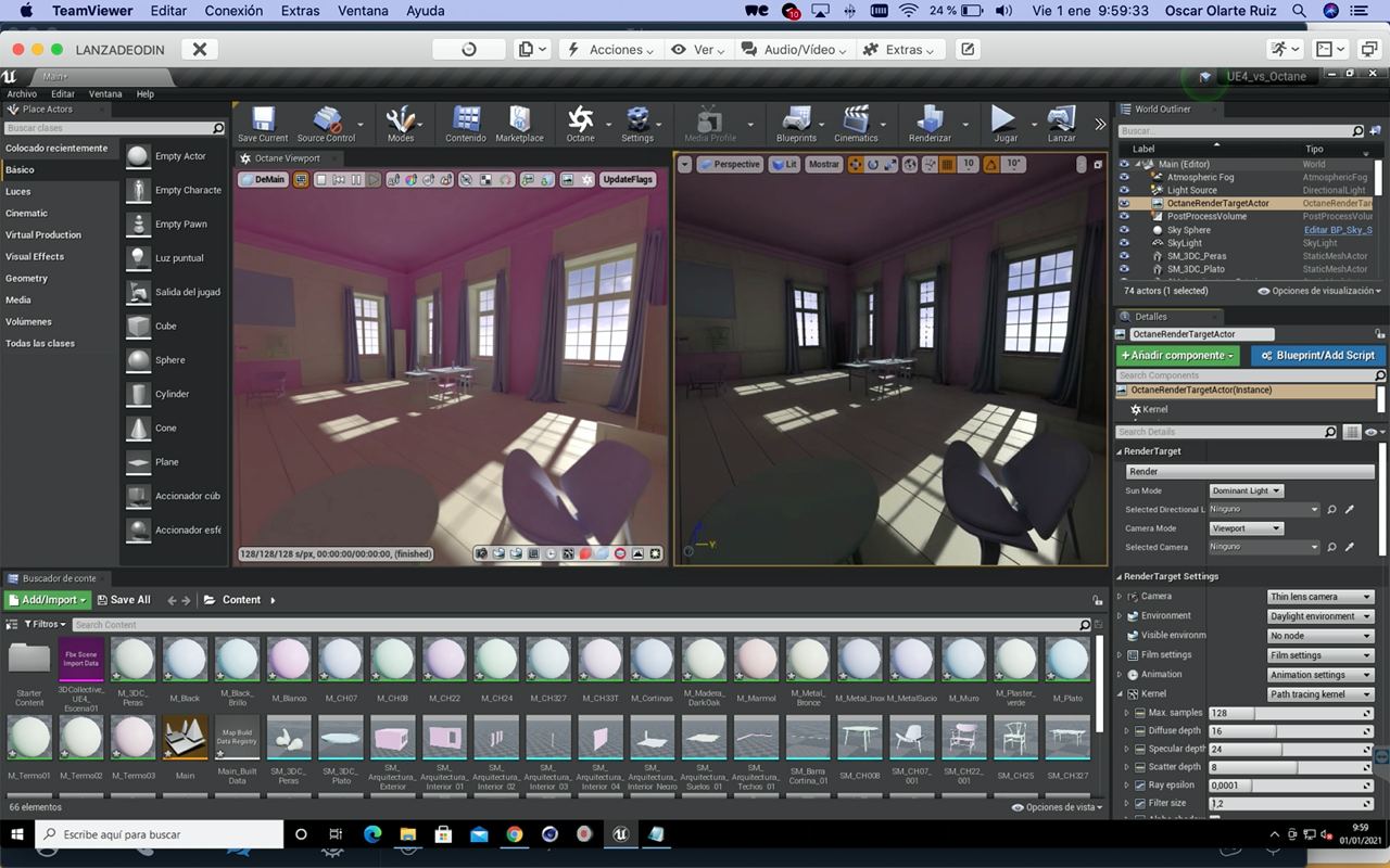

Hello Chris
Please implement Lightmaps baking inside UE4, tested GPU Lightmass against Octane Render, and it is still very bad.
1-No Multi-GPU support = Still very slow if it is needed to reach production quality.
2-No Unbiased Render = Need a very time consuming tweaking to get photo-real results.
3-Very poor control of render engine parameters = Can't adjust quality to projects needs.
4-Lot's of render artifacts = There are lots of artifacts very difficult to find workaround and hacks
5-Needs a difficult to find artist to get hyper realistic results = It need a very experienced artist to know all the tricks, cheats, hacks, workarounds to get photo real result.
6-Problems of color workflow = Even using UE4 OCIO support, still lots of problems to get color consistence to render the UE4 project for color grading.
7-Since there is no Multi-GPU support, cant take advantage of GPU Render Farms.
8-Checked the load for GPU, it's not optimized, working only at 50%.
9-Bad 3d Scene interoperability. Even with USD is only intended for import, lack a ORBX scene approach to share the scene between different DCC tools.
10-Lots of problems supporting big big texture maps such 32K or higher = With octane you can support big texture maps without problems even with DDS compression.
I truly believe there is a good opportunity for Octane Render as an alternate Render Engine for UE4, even more if we take into account the growth of virtual production.
Happy new year.
Best Regards
Oscar

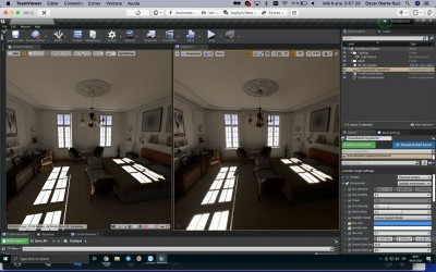

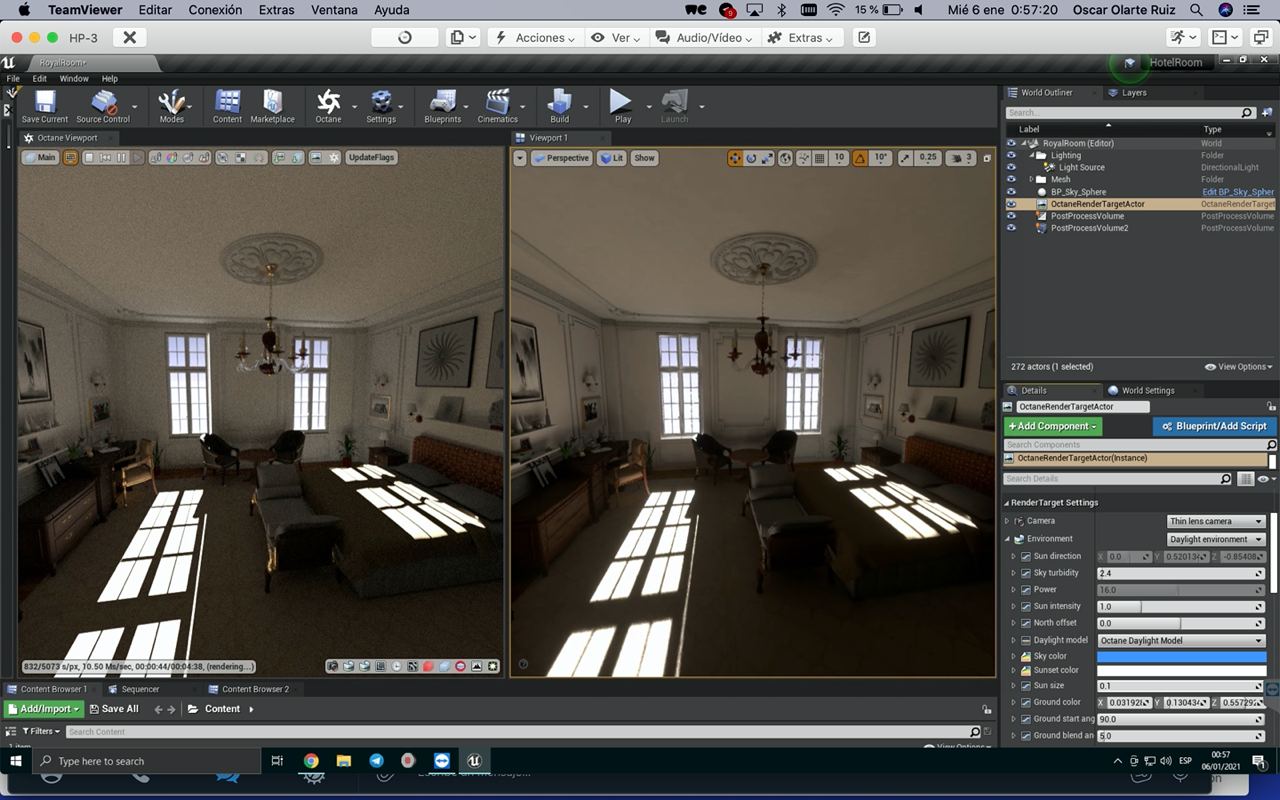

There are lots of artifacts in both, GPU Lightmass and Lightmass. Supposedly new UE4 4.26 GPU Lightmass is based on Luoshuang's development, but we obtain much better quality with original GPU Lightmass https://forums.unrealengine.com/develop ... ss/page131 (there is new version 4.26) you can compare both (Luoshuang's 4.26 GPU Lightmass replaces CPU Lightmass while you can use UE4's GPU Lightmass and compare both, you will see the difference). With Luoshuang GPU Lighmass you can modify Engine/Config/BaseLighmass, to reach better render quality. At the end of the config there are these parameters, i've modified.
[DevOptions.GPULightmass]
NumPrimaryGISamples=64
NumSecondaryGISamples=64
FireflyClampingThreshold=1000000
With [DevOptions.GPULightmass] settings and world settings: static lightning level scale=0.1, indirect lighting bounces=100, sky indirect lightning bounces=100, indirect lightning quality=10. We get a reasonable quality with Luoshuang GPU lightmass. Find attached a fast test from UE4 downloaded scene.
With this approach we can use OctaneRender UE4 plugin as a Ground Truth reference and then we try to replicate the same color and light in UE4, so that we use UE4 baked scene for Previz and we use OctaneRender for final render. We are testing right now this workflow, but is quite awkward, and difficult to get almost the same colors, lights, and results. We are building one scene from scratch with Luoshuang GPU Lightmass) and OctaneRender plugin to test this workflow. Meanwhile, in production we are still stuck to bake the whole scene in OctaneRender and then render by pases (diffuse beauty pass, roughness material pass, tangent normal, displacement material pass...) and then import all pases to UE4, this process is very tough and time consuming. We are very excited with Brigade launch or if you finally support lightmaps bake within OctaneRender plugin for UE4 (please do).
An example of our painfull baking process octane-UE4. https://vimeo.com/457778383/18729c9e32
Best Regards
Oscar Olarte
Downloaded test scene, using Luoshuang GPU lightmass with high quality settings, using OctaneRender as a GroundTruth reference.
