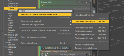

Remember there is a added feature to correct a skin/texture that has gone to black when the material is added, simply pressing CTL+ALT+R to replace the maps of the material or R-Click on the material then "Texture for" then choose "Replace All Active Maps". Now you will say why don't they just do that automatically, well as stated some material convert acceptably so not all maps need to be brought back from Studio, Making that a checkbox option would be a good idea too.

Thanks for the info, by the way I've tired many times and the ctrl alt R has never worked for me and still does not. But forget about me for a second, I've been playing with Octane for over 5 years. How about the thousands of Daz users who try the plugin, see the results and figure Octane is fast but looks nowhere near as good as Iray and abandon it and or takes way to much tweaking to get decent look. This community is dead, but with a little investment in the plugin I could see I can see many users dropping iray and switching.
