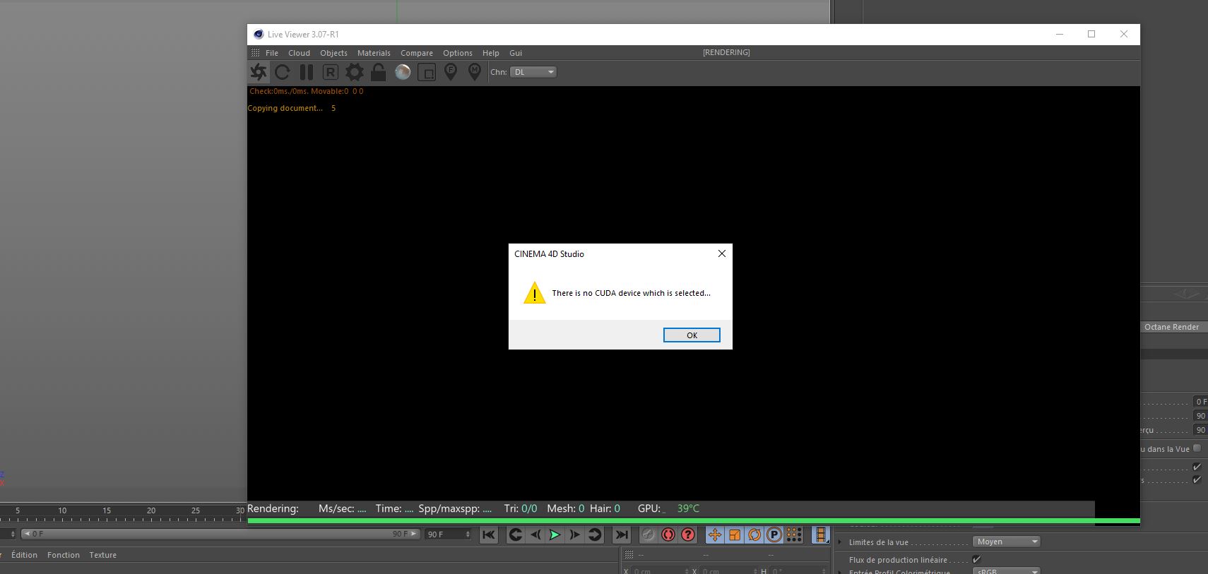

In fact I have a TRX 2080ti Ram 64g 3600mhz And a ryzen 9 3950x as a processor.
I am using C4D R19 and I just installed the Octane plugin for this version of Cinema. When I press the Octane button for rendering in the live viewer, the message "There is no CUDA device selected" appears although I have installed the latest CUDA Toolkit (10.1) and have selected the graphics card (RTX 2080ti) in the octane preferences. Do you have any idea how to resolve this error?
here is the message displayed by octane
Posts: 10575
3.07 is a very old version, no more supported by recent Nvidia driver, currently we are at v8 stable 2020.1.5-R4.
You need to install at least v4.05-R7, or greater, to be able to work with recent Nvidia drivers.

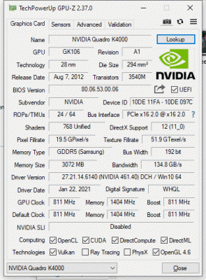

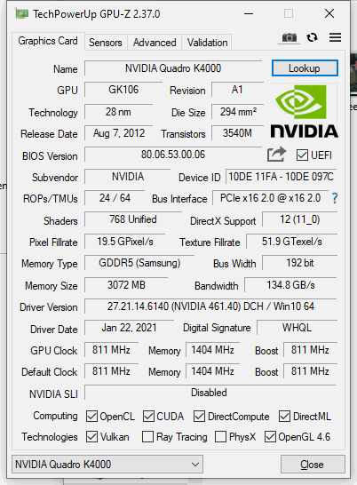

Hi there,
I have the same issue:
C4D R23.110
Octane 2020.2 R3
Benchmark:
Octane version:
2020.1.5
Operating system:
Windows 10 64-bit
RTX enabled:
no
Devices:
Quadro K4000, 3GB
Total score:
20.577874

HI there!
thanks a lot for your help! I think I made a mistake while installing the plugin the first time ... the C4D App was open while I installed the cuDNN...
now I reinstalled everything, but there is a new problem:
the Octane plugin is still installed and shows the same Problem, eventhough I reinstalled C4D and deleted the plugin folder.
any idea?
Best Max
maximaximax
Posts: 3
Joined: Thu Feb 25, 2021 12:16 pm
solved the problem by using the older octane version 2020.1.5 r4 - maybe the newest version doesnt support my Card (QuadroK4000) anymore?

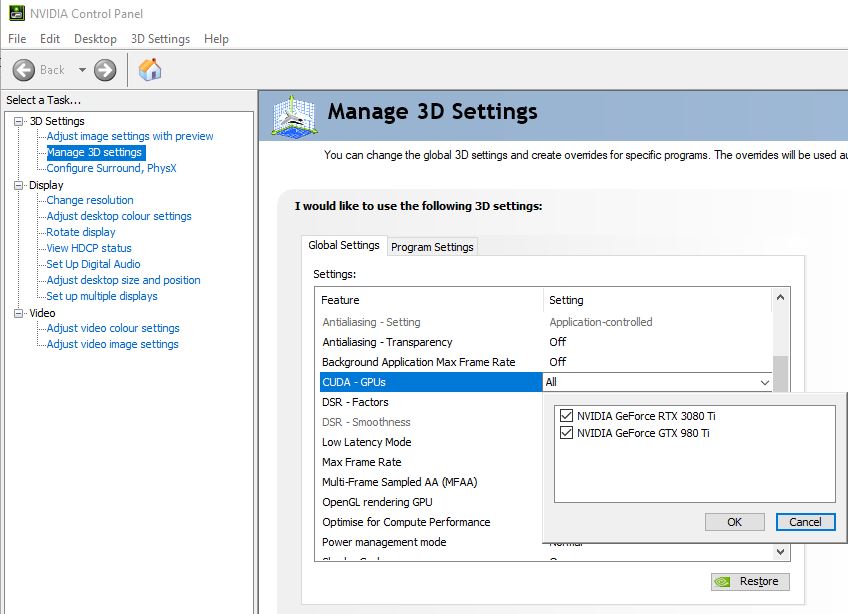

Had this problem a couple of times, somehow Nvidia made one of my cards not eligible for cuda performance.
I solved it in the Nvidia Control Panel (accessed by right click in the desktop):
