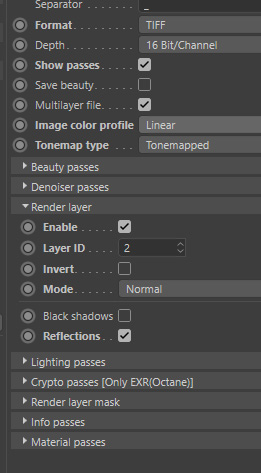

I'm trying to use the reflection pass that I have saved from Octan-passes (I've tried to use linear/linear or srgb/tonemapped with no difference), but when I try to compose my background image with the reflection the results are not what I expect.
