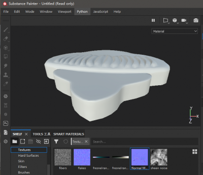

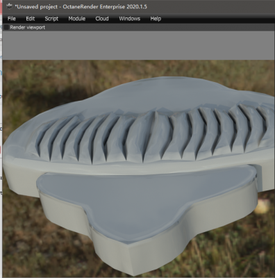

The normal map does have some effect in Octane. But the sharp edge or corner just cannot be displayed as round as in Substance.
May I ask what's your method to bake normal from substance for Octane? Or should I change some settings in Octane ?
I have attached a simple mesh shows in both Octane and Substance.
Many thanks.
same normal map but still looks very sharp in Octane
Mesh with sharp edge looks round on edges with normal map in Substance
