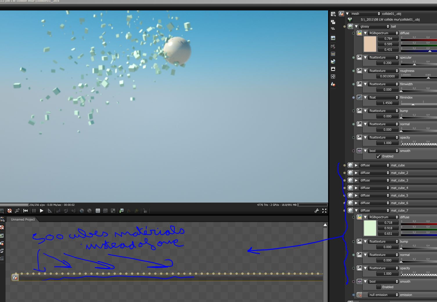

I was very happy because the particles instancer of lightwave was workink with Octane.But there is a big problem:
when duplicating the instance geometry ( see attahced pict) with the particle FX linker, and after expoting the scene to Octane, Each cube has A NEW MATERIAL in octane ( ex: 500 cube -> 500 materials ): so that is quite impossible to change the material of cube, specially when working with animation...

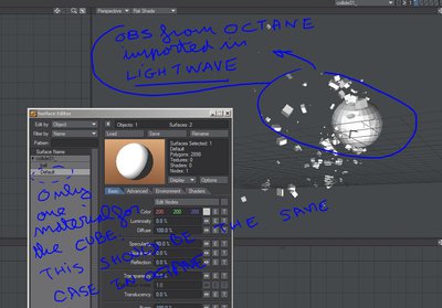

BUT IT'S PERHAPS AN OCTANE PROBLEM because when i load the exported octane-OBJ in lightwave, it doesn't shows the 500 cubes-mats but only ONE (this is logic... -> see the top attached pict).

open the mlt file in the notepad and check out how many materials there are. There you should see if there is only one material definition, or there is hundreds like it shows in Octane. I don't quite know how it works in LW, but in max when you apply a particle instancer by default they get no material assigment, and you have to reassign a new material, depending on the instancer the particles can be a single object or multiple, hence have one material or many, so if you don't assing any, I guess something like what you see should happen at export.
THANKS A LOT FOR THE TIP.
I've reedited the mlt file, deleted the 499 materials definitions and saved it with read only mode ( so that animation can't rewrite mlt file) and now it works !
In fact it seems to be an exporter problem, which rewrites a new material definition for each duplication...
