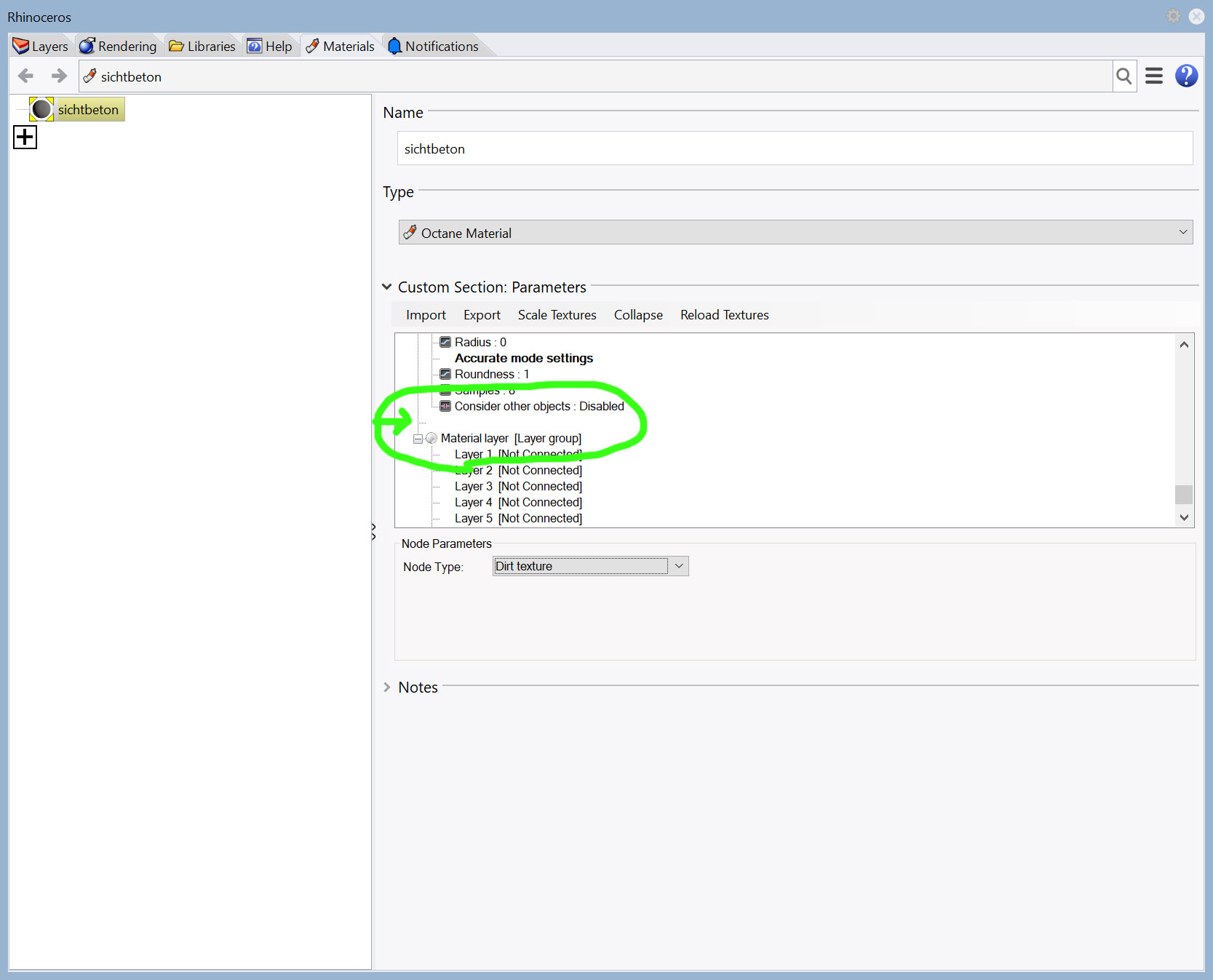

today I spent about 2 hours to hunt down this bug which has been very annoying here since a few month.
I often get a cuda error like this:
"Error
Cuda Error Loading Scene: Tried to access pin via invalid Index 5 (this can be also any other number...)
tried to access null node pin
tried to access null node pin"
Often I get these Error messages like 6 times in a row with different numbers for the index.
As the error message does not give me any information which material is damaged, it is very hard to find the culprit(s) in a complex scene!
When I look at the material itself it is obvious that some nodes are void ( see attached picture )
I is possible that this is happening with materials I did with an earlier version ...

ok now it gets really weird:
I was under the impression that the material is the culprit, but as it seems I was wrong.
I deleted the original material and replaced it with a default octane material... the same bug!
here is the scene:
https://drive.google.com/file/d/15w8hnO ... sp=sharing
it is something with that cube... but what?
just noticed: copy and pasting the thing to a new default rhino scene seems to cure it ...
Andreas

Hi Andreas
I think I have resolved the crash problem (and I will post a release in the next 24 hrs). However the cube still does not render, and it appears to be something to do with the polygon/vertices (as per the other thread viewtopic.php?f=41&t=76363). I will await OTOY's comments on this problem.
Paul

Release 2020.1.5.123 (see release thread) will hopefully resolve the crash issue.
