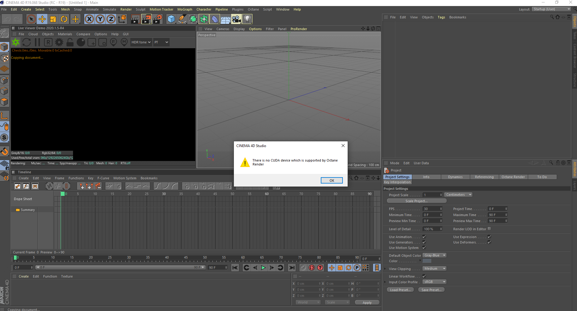

I installed Octane Demo for C4D on my laptop and I'm getting the message "There is no CUDA device which is supported by Octane Render"
I have GeForce RTX 2070 Max-Q. I've used Octane on this device with a license in the past, and it's worked with no problem.
I've attached a screenshot of what I'm seeing.
Is there an older version of the demo that I can download? Any help is greatly appreciated. Thanks in advance

probably using old Nvidia drivers
Posts: 10614
you need an Nvidia driver greater than 451.00, to be able to run Octane 2020.1.5.
Please perform a clean installation of the latest Nvidia driver for your machine.

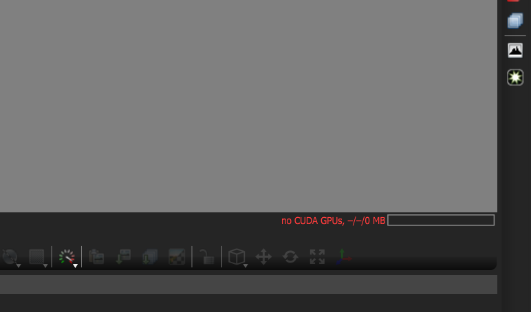

I've got the newest laptop Asus Rog Zephyrus with GeForce 3060 Laptop 6 gb, Latest NVidia Driver 516.01, Latest CUDA version 11.7 win 11 and I've got the same problem! Please, help me!

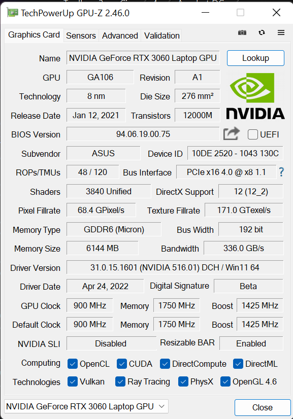

Please, also download and run GPU-Z:
https://www.techpowerup.com/gpuz/
And share a screenshot from the Graphics Card tab of the Nvidia GPU, thanks:

I understand the need to use the latest version of standalone for RTX 30X0 videocards. I didn't upgrade my standalone V4.05 version. I'm just trying to use PRIME FREE TIER version for personal use in Blender and DAZ3D with the Prime 2021.1.4 Octane Engine. In Blender and DAZ studio still no GPUs..

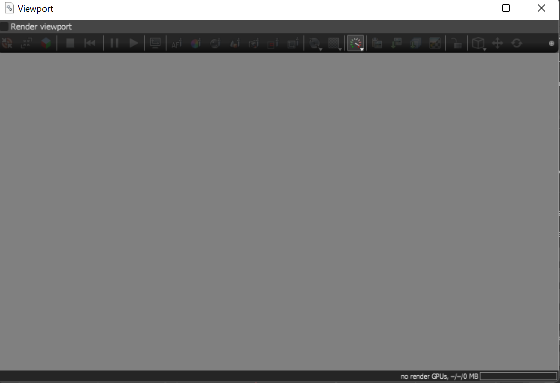

Here you can see my octane viewport in blender

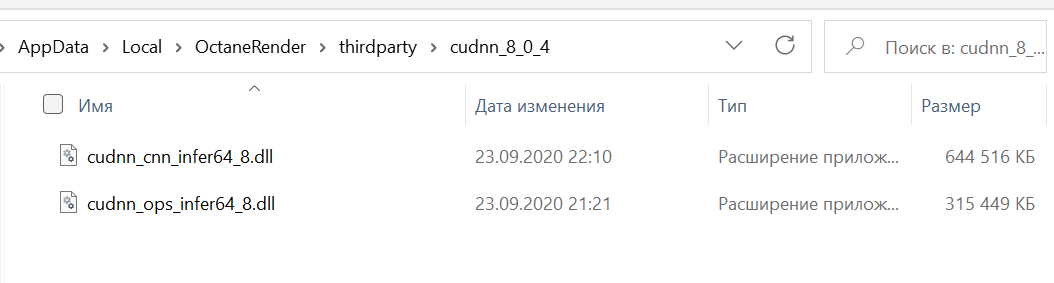

Have you installed the cuDNN library 8.0.4?
If not, please download the cuDNN library from the following link:
https://render.otoy.com/downloads/ef/08 ... _4_win.zip
Then navigate to C:\User\Your User name\AppData\Local\OctaneRender, create the thirdparty directory, and copy in in it the 8.04 cuDNN library unzipped folder.

[quote="bepeg4d"]Have you installed the cuDNN library 8.0.4?
It has already be installed there! Still have the same issue.. I don't know how make it work... :cry:
