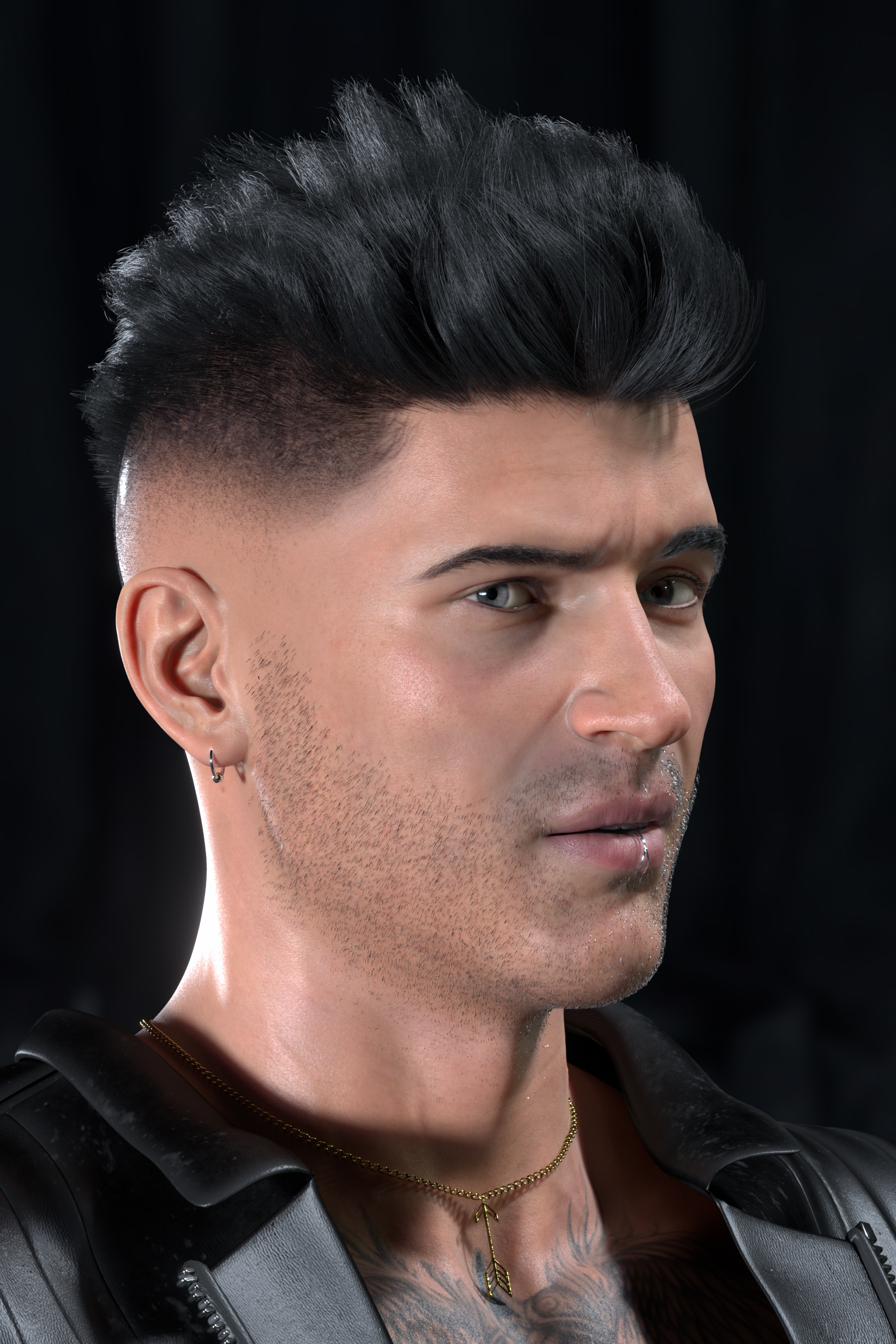

Specular/volume materials really do seem the best to get a good skin. I have tried using the diffuse method before but never really liked the results. This was my most recent I did with the random walk sss. it was a diffuse/diffuse each with a specular layered material for the shine. And while initially I thought it looked good, I found it still didn't seem right. I'm currently working on something using just a specular node with random walk sss and am having results which seem better.

Random Walk on specular material is definitly the way to go for the best looking skin. It does have its drawbacks tho.
First, specular material, especially scattered ones, take a lot of time to render. You also need decently high diffuse and specular depths to work which also increases render times.
Second, I often render interior scenes that are not always brightly illuminated. This material will look terrible in low light settings as it needs a good amount of light to look good. If there is not enough light the specular material will look terribly noisy and just awfull in general.
You can get okay results with using random walk on diffuse material in those scenes but everytime I compare it to glossy skin shaders, I dont see much of a difference. So for indoor scened i tend to use glossy or diffuse with specular layer.

It seems I lied. The image i attached is was made using the specular style with random walk. I forget how far I progress on my projects sometimes lol. But more specifically it is the universal material with full specular, no diffuse
