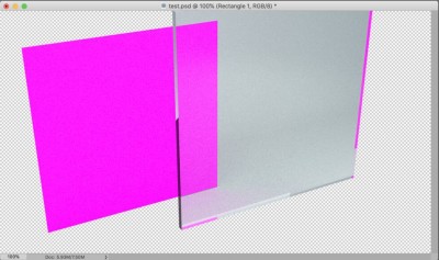

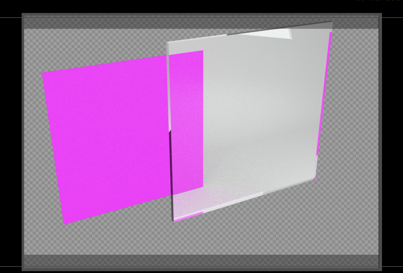

Hi, I'm attempting to render out a PNG with proper alpha/transparency
For the glass material I'm using Octane Specular Material:
As you can see from the viewer, the object behind the sheet of glass is visible, but the background is not:

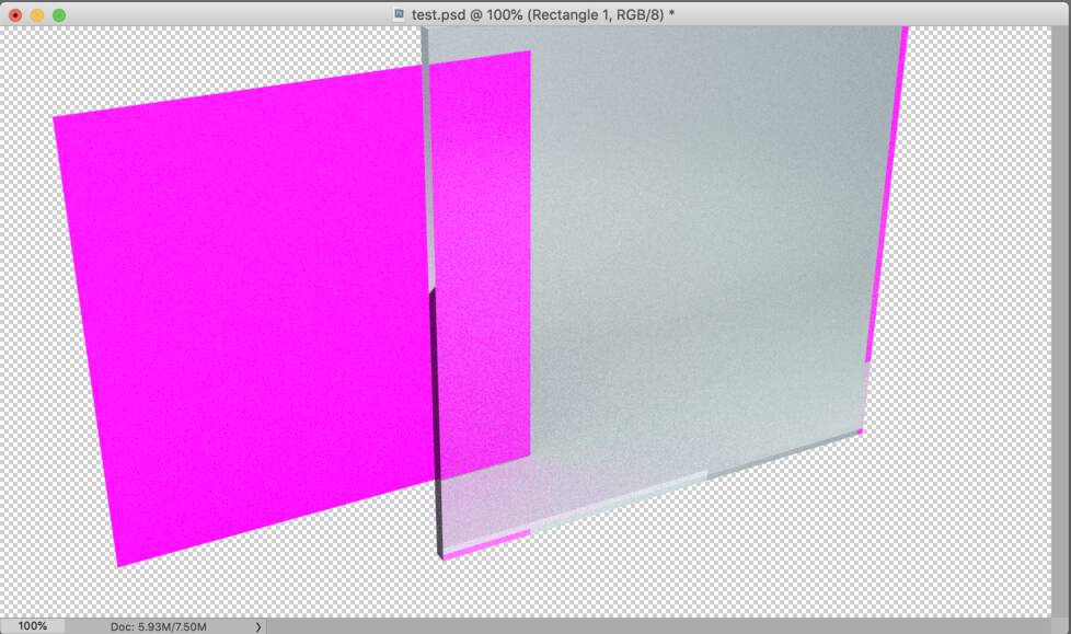

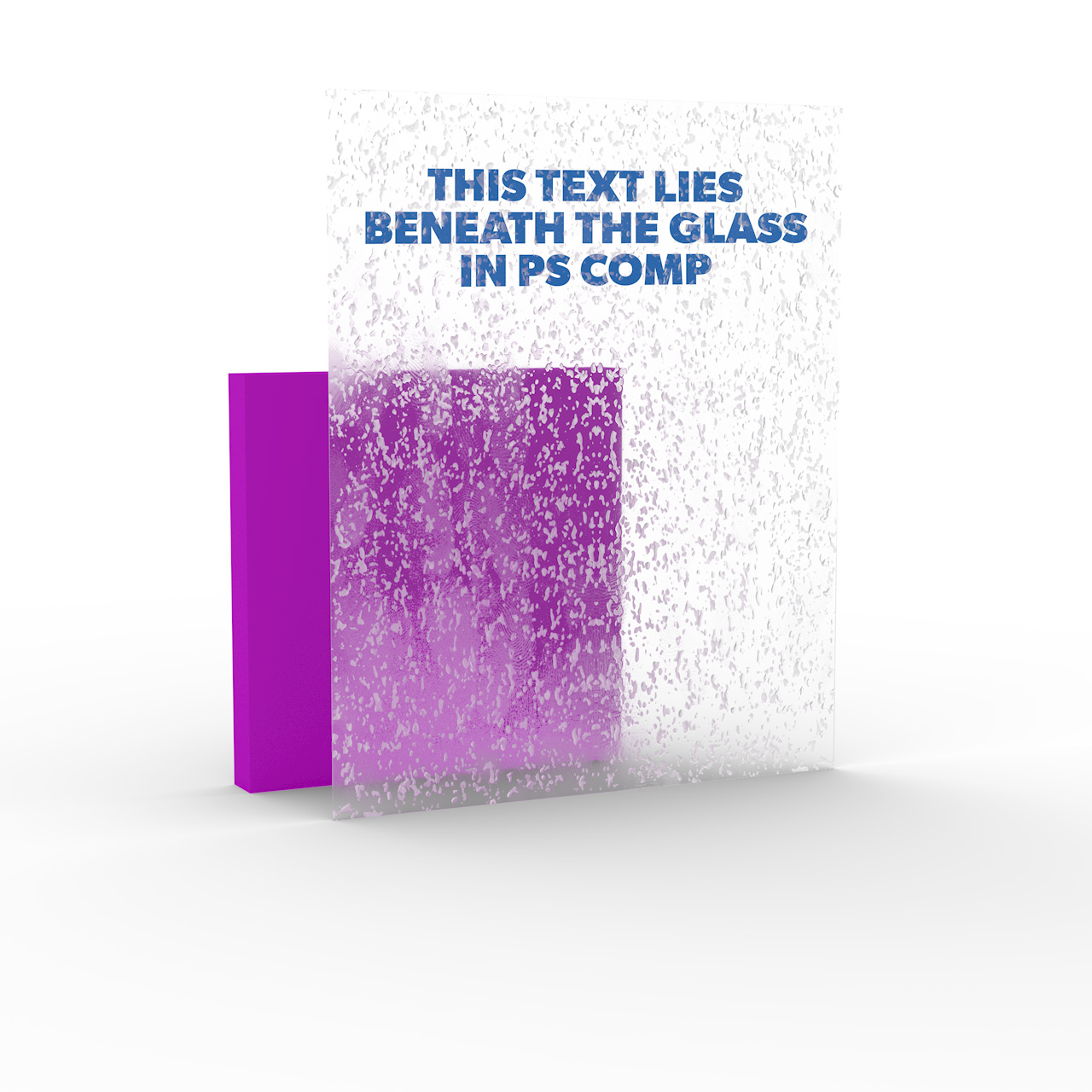

Same goes with viewing the output PNG in photoshop:
Any clues as to how I can achieve this? i've played around with the opacity, but that isn't really what I'm after as I want the reflections to remain solid

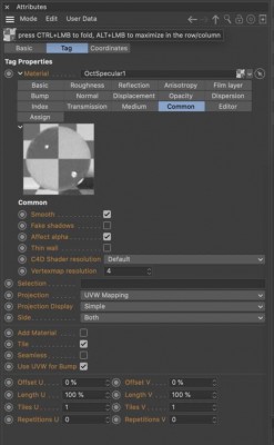

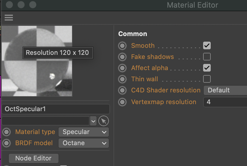

In your transparent material you should check "Affect alpha" in the common tab. It's seems like you have Alpha shadows checked in render settings and thats also a must.

Thanks for your reply, I already have that checked;

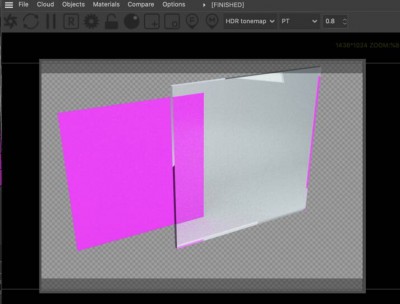

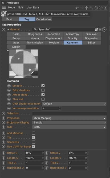

Also even before I bring it into PS, I've noticed the chequered bg in the Octane viewer doesn't show through the glass:

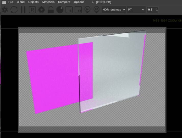

Sorted. Disable your backdrop and you're good to go.

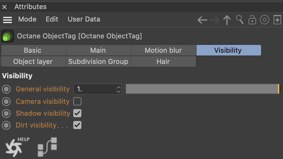

Ah, but I wanted the reflections of the backdrop on the glass to remain, I couldn't see a way of just selecting reflections in the object tag:

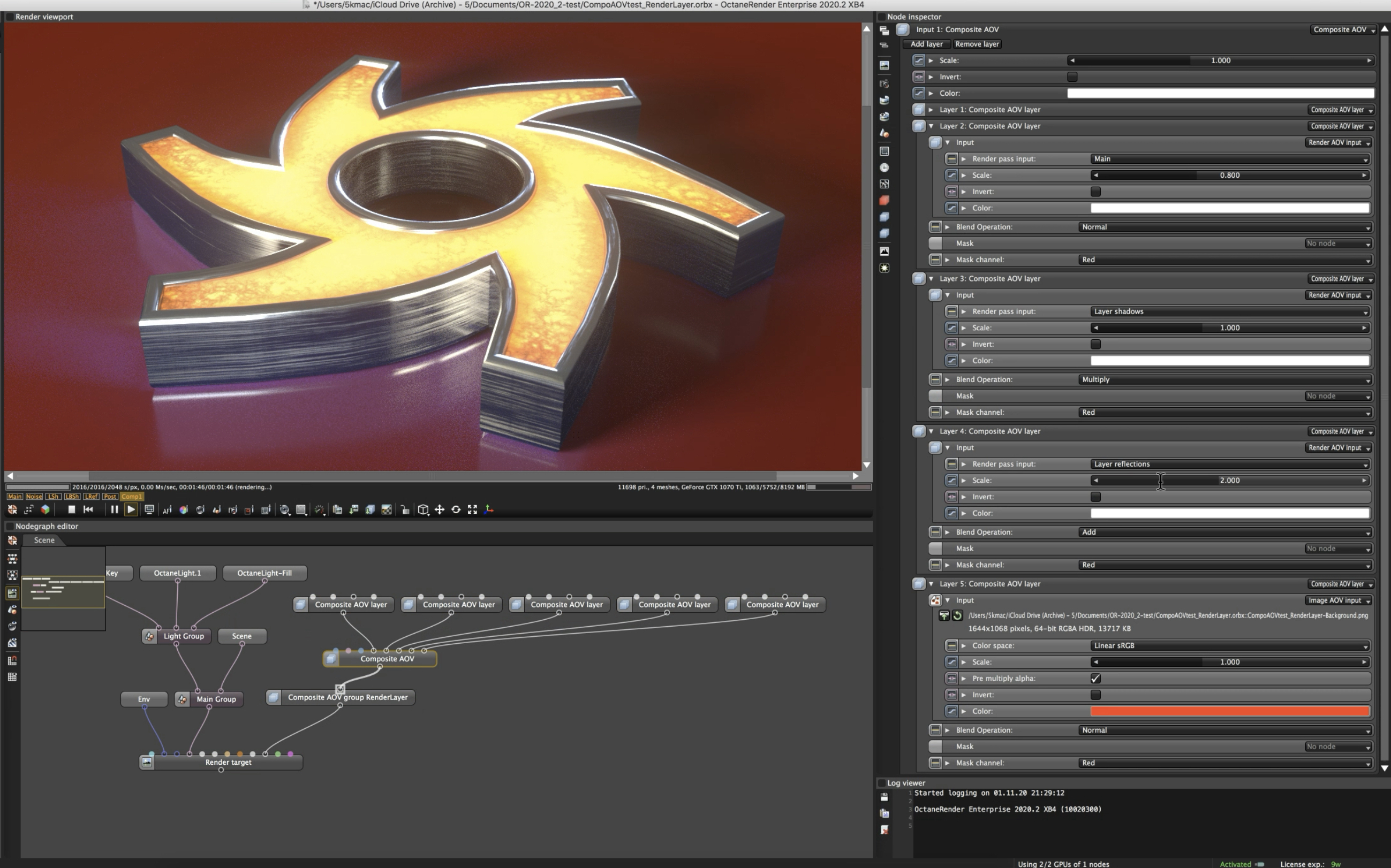

Posts: 10490
Hi jhansen,
Render Layer workflow is going to be greatly enhanced in 2020.2 SDK.
With the upcoming AOVs Composition nodes, it will be possible to see and fine tune full Render Layer result directly in Live View.
Here is an example made in Standalone 2020.2:
For now it is only for CUDA, but it will be also added in OctaneX soon.
