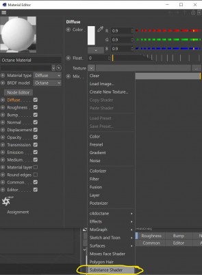

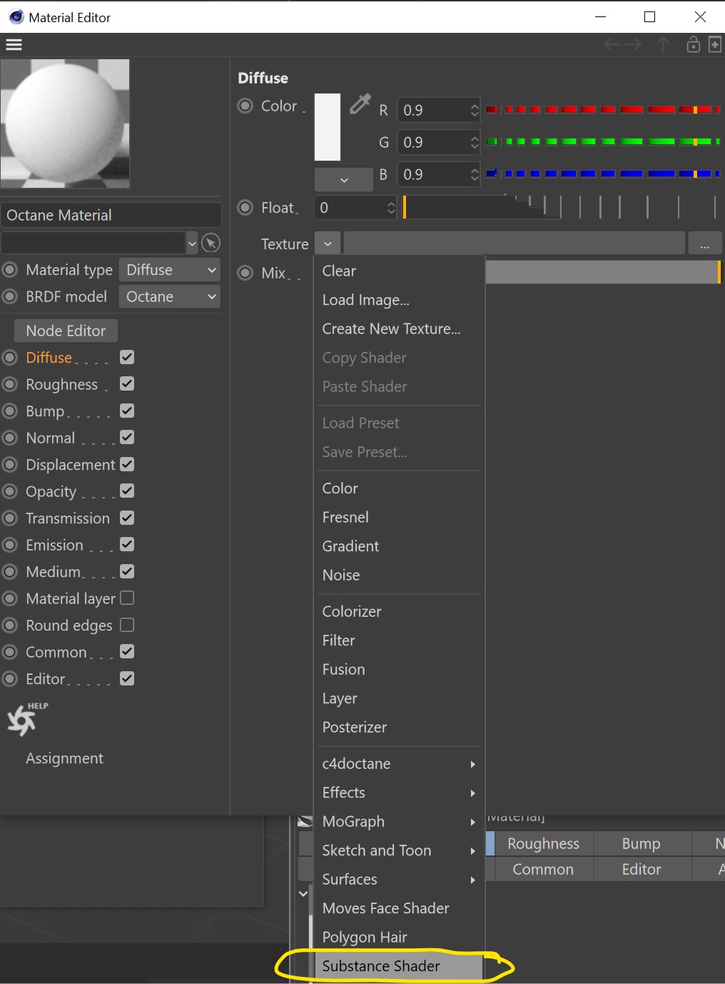

Hello,
I'm trying to use Cinema 4D's Substance Shader with Octane 2020.1.5-R2.

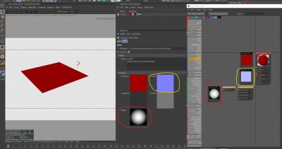

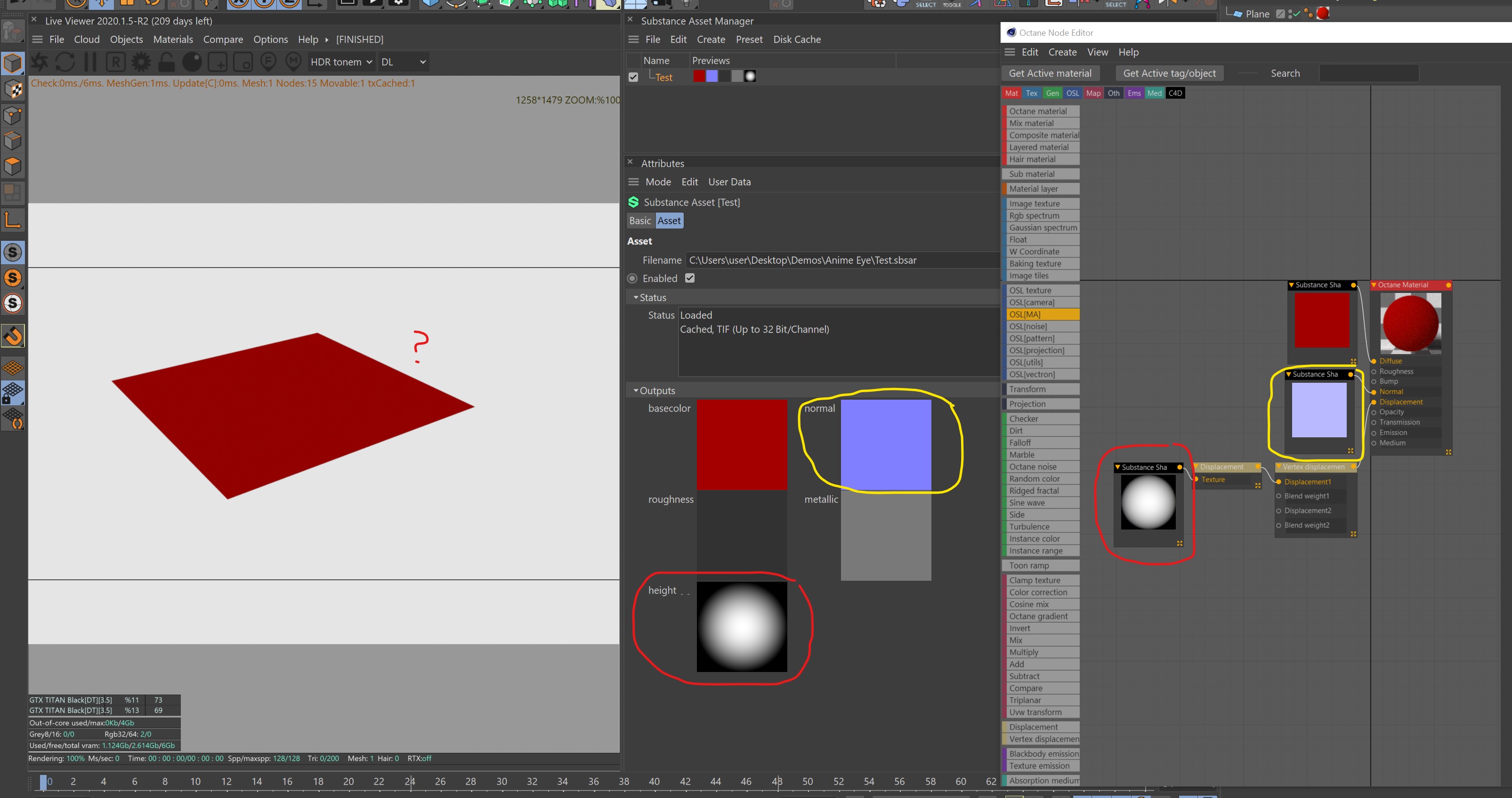

The color pass seems to work okay in the Diffuse channel, but the Normal pass' thumbnail appears to have a different gamma than in the Substance Asset Manager.
Also, I am unable to get the height map working with the Displacement channel. I have followed the same steps as in this video:

Substance Shader and Node Editor

Hello blastframe, set the gamma of your normal map to 1.0. The Image Texture node will default to 2.2.

Hi @jayroth2020, thanks for the reply. There is no Image Texture node. It is the Substance Shader which has no Gamma parameter.

In that case, I would submit a support ticket. I would bet that the normal map is getting a gamma 2.2 applied to it under the hood. The screen capture you showed sure looks that way to me.

Here is a scene file demonstrating its current behavior with Octane for Cinema 4D:
https://drive.google.com/file/d/1KqhQI1 ... sp=sharing
Some channels seem to work, but as I mentioned the original post, the Normal map seems to have a different gamma and Octane's Displacement node does not seem to accept the Substance Shader.
