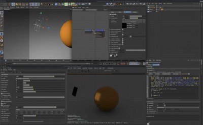

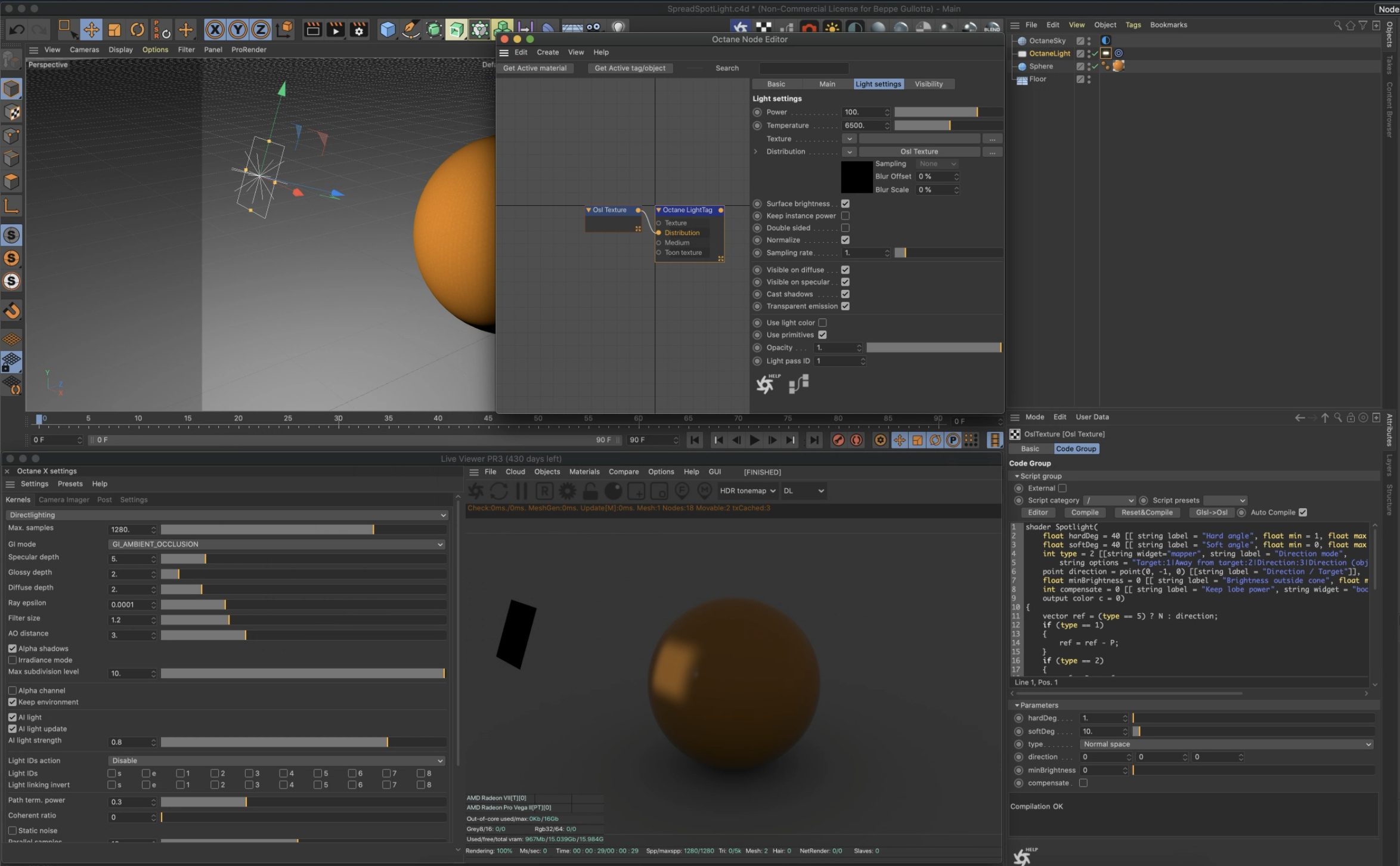

I've been watching GTC 2020 presentation and noticed the new Spread Function OSL input for emission distribution. This looks very handy.
I've had a look around in C4D Plugin 2020.1.5 and well as SA 2020.1.5 but cannot find it.

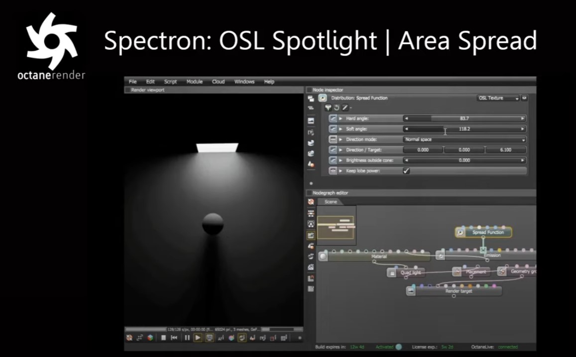

Here's screengrab from the presentation
Here's a screengrab from the 2020.1 Features list on the Otoy website.
It looks like it should just be OSL code that could be copied into the OSL texture.

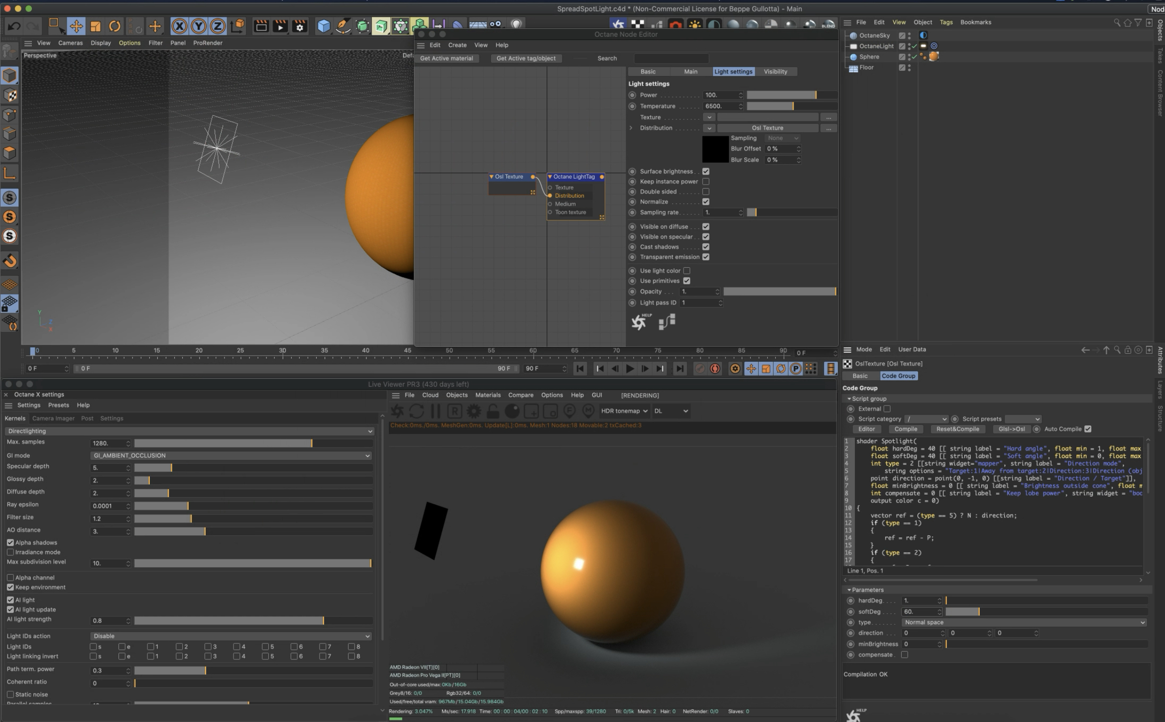

here is an example scene of the Spread SpotLight OSL script in c4doctane:
SpreadSpotLight.c4d.zip
(53.97 KiB) Downloaded 422 times
P.S. it works also in OctaneX PR3
