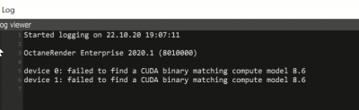

when I try to render I get this strange message (screenshot attached):
OctaneRender Enterprise 2020.1 (8010000)
device 0: failed to find a CUDA binary matching compute model 8.6
device 1: failed to find a CUDA binary matching compute model 8.6
I can't render. what should I do? contacted support via email, but while I'm waiting - maybe someone here can help?

The first step is to update to the latest version of the OctaneRender for Poser plugin - 2020.1.5.104. Then make sure your NVidia drivers are up to date. And make sure Octane Standalone renders.
Paul

Paul, it's working now!!! thanks <3
maybe you guys should update the download page? the latest version there is the .102. I had to go to the forum post in order to find the version that you referred to.
