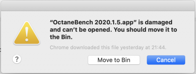

I am trying to run OctaneBench 2020.1.5 on my mac, but get this error:
“OctaneBench 2020.1.5.app” is damaged and can’t be opened. You should move it to the Bin.
Any ideas why? I am running Catalina 10.15.7

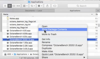

Ok, please try these steps.
  • locate the OctaneBench 2020.1.5.app, right click on it, and choose “Show Package Contents”:

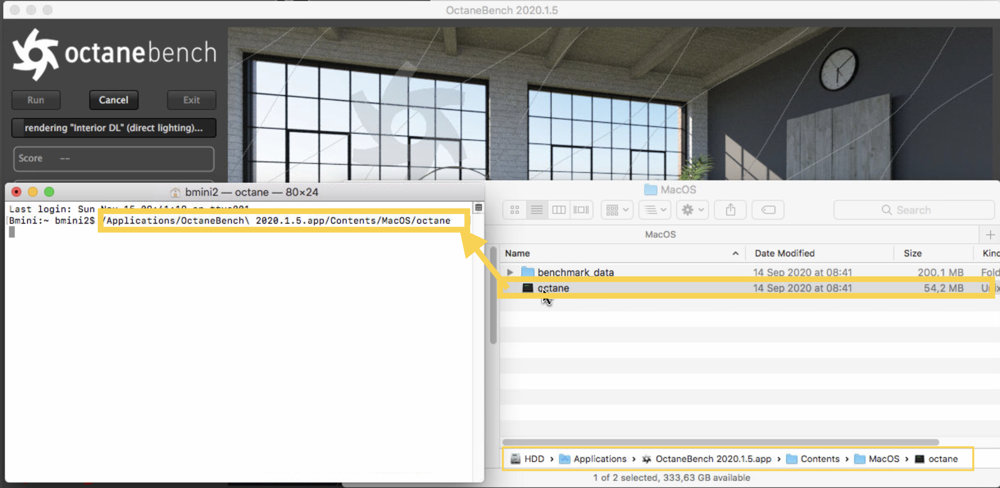

  • Navigate to Contents/MacOs/, open the Terminal.app, drag and drop “octane” into the Terminal window, and press ENTER:
In this way, OctaneBench 2020.1.5 should start correctly.
