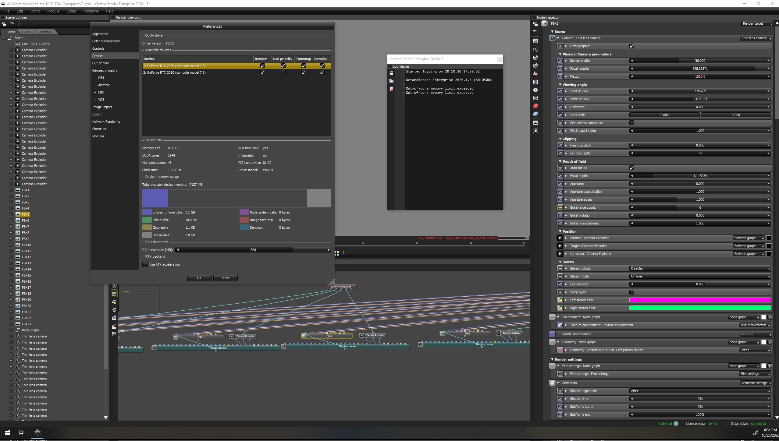

Here is a screenshot of the screen after failure:

SamuelAB wrote:All it says is
Out-of-core memory limit exceeded
I tries with 5G, 15GB, 30GB, 40GG and 50Gb of out of core memory.
I will PM you a link to the file if you want to look at it.
Hi, I'm an Octane developer looking into improving the ability to use out-of-core memory in situations like this. Could you please PM me the scene? It would be great to get some more information about exactly why Octane is having a problem with this scene.
One thing to note is that the OOC limit you set in Octane preferences is just the maximum that Octane will try to allocate, but there is another limit imposed by the OS/GPU/drivers (it appears to be impossible to know what that limit is until you hit it). It's unlikely you'll be able to use 50 GB of out-of-core memory even if you set that as the limit in Octane. Improving the user messaging around this limit is one of the things I'm looking into.
