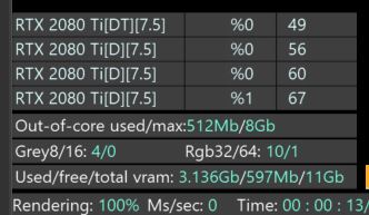

Been noticing this more and more as of late across all my projects. I have 11GB available, but as you can see in the screenshot below it's coming in FAR below this.
Latest studio drivers (with a full DDU clear prior), windows drivers, Octane version. No apps are open in the BG with a fresh system restart.
I notice when I open the project and start working I have access to all 11gb (8ish after windows), but the longer I work/toggle layers/etc that FREE amount gets lower and lower, eventually leading to a CUDA crash.
I do environments, so all that's in my scene is a height map displaced, scatters and a HDRI. Nothing too crazy, and going back a month or so I had never encountered this.
Any ideas on this?
Thanks for your time!
AW

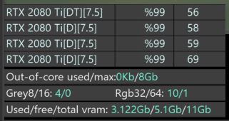

As a follow up, restarting C4D and not changing the scene at all, the attached screenshot now shows the correct values.
Again, I changed nothing other than restarting. However as I said above this number will go down as I work leading to a crash (without adding anything to the scene)
Weird?
Weird?

Thanks alot for your reply Tom.glimpse wrote:Good day Aaron,
what that error say is that Your mesh does not fit into GPU memory and RTX starting to have problems.
one way to solve this would be to actually disable RTX (no RTX boost anymore), so even if mesh or textures goes out of core, You would still be able to render with a bit of penalty.
if You see huge RTX boost, from RTX On, might be wise to do disable couple of cards, set NVLINK between other two and finish rendering with NVLINK (& RTX enabled) on two cards rather than Out of Core (without RTX).
not sure if that makes sense, but basically Your scece is close to the edge and seems that RTX is freaking out - also might be the cause why You see VRAM being messed up (just a guess).
let us know how it goes.
Sinc.
tom
Rendering this scene with/without RTX is with 30 seconds, without 1min40seconds so RTX is needing to stay.
Wondering if you might have any further insight. With RTX ON, a fresh launch of Cinema and a fresh launch of the scene i'm working on. All assets are on and I have 5.15 used, and 3.5 free. So with all assets on I still have 3.5gb free (after the fresh launch).
How could it be that through working on the scene (adjusting daylight/material balancing etc) I then am running out of memory and have to relaunch cinema to get my 3.5gb back?
