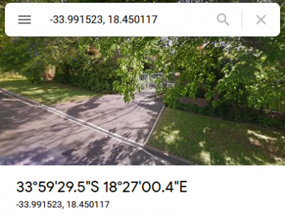

The format of the coordinates from Google Maps is like this, I use the second ones I'm assuming. Is that correct?
20°00'00.0"S 20°00'00.0"E
-20.000000, 20.000000

Hi Juan,
I'm using them directly out of Google Maps in this format -33.991523, 18.450117
I align my model to north in layout, but the lighting results are incorrect in all 4 directions.
