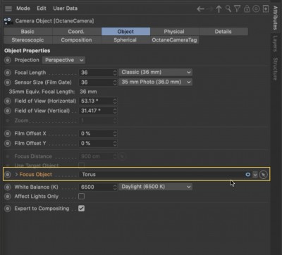

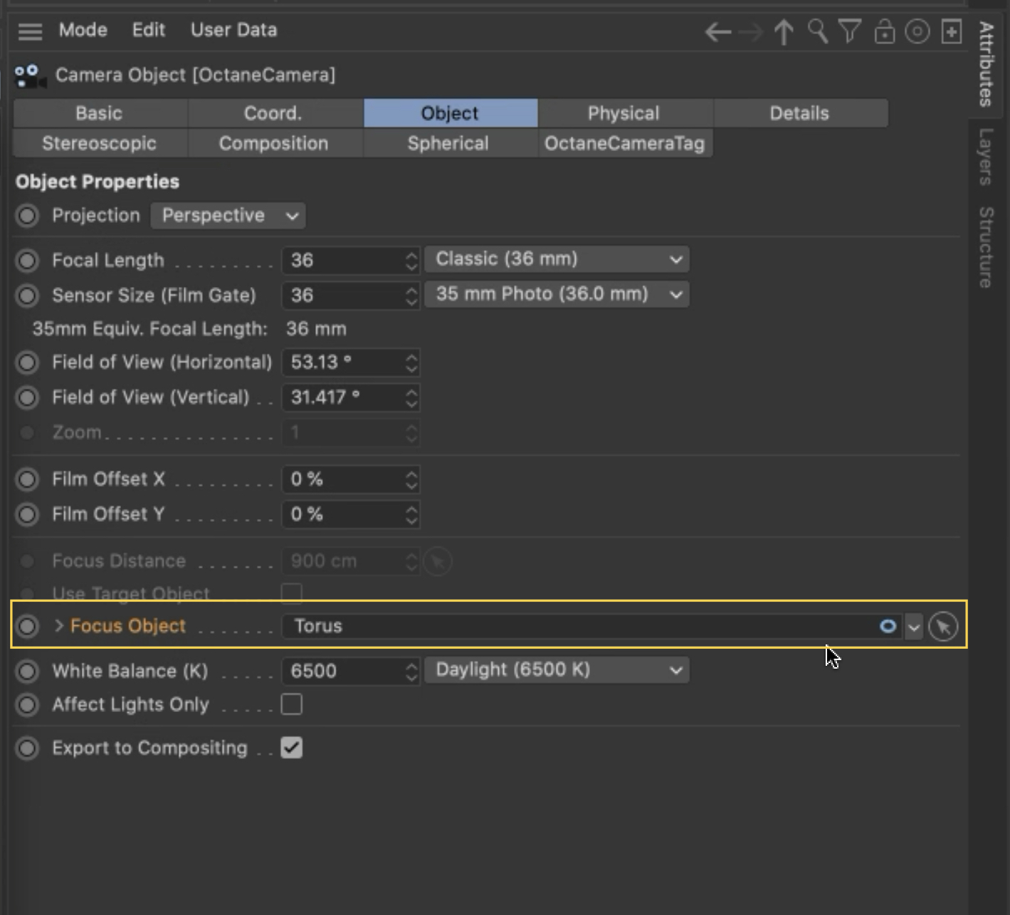

AutoFocus is designed to focus on the center of the film plate, if no objects are in the center, everything goes out of focus.
But Autofocus by Object should be very easy to obtain with an integrated plugin :roll:
For example, in c4doctane, the Camera object is the c4d standard c4d Camera with an Octane Camera tag, and in the standard c4d Camera object there is already an option for focusing on a specific object:
ciao Beppe

bepeg4d wrote:Hi coilbook,
ciao Beppe
