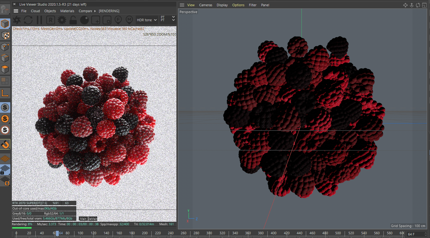

I have a huge problem that I can't solve. A week ago everything looks perfect, octane and cinema 4d all good.
A week after I open cinema 4d and look at the octane live viewer and is all noise, It was like if I downgraded my gpu or something,
The thing is that a week before it was all much faster and without that noise. This render, for example, is not a complicated one, and takes so long to see it.

Posts: 10475
please check to have set the MoGraph cloner to Render Instance.
Now your scene has more than 32 Millions polygons!

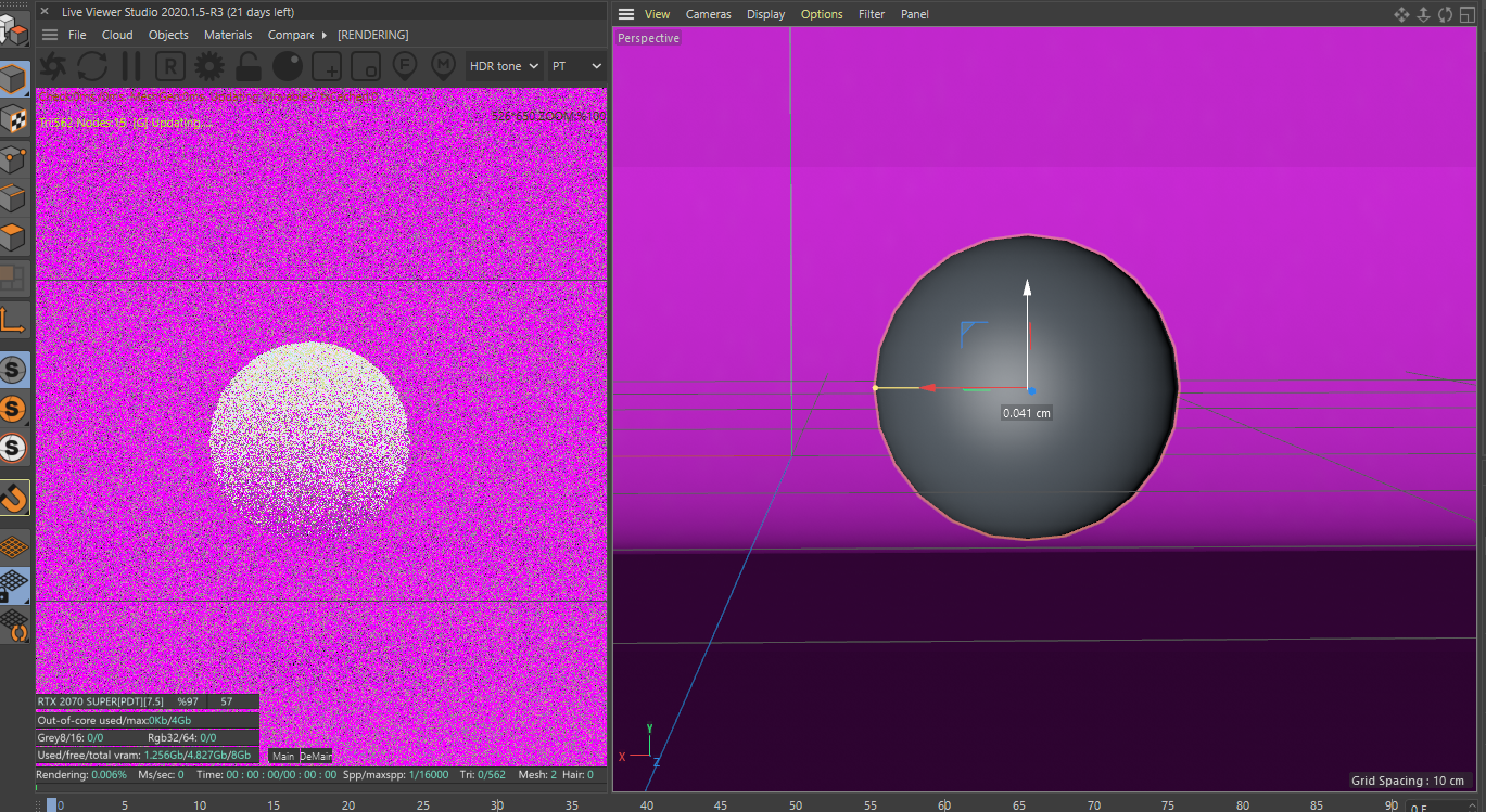

It is not the scene... look here. Just a sphere, background plane and hdri light.
Besides last render files works great a week ago... I'm lost...

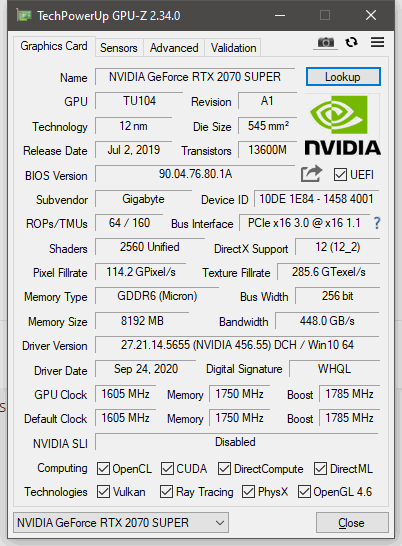

What about the installed Nvidia driver?
Please, download and run GPU-Z:
https://www.techpowerup.com/gpuz/
And share a screenshot from the Graphics Card tab, for all the available Nvidia GPUs, thanks:
Please, also download and run octanebench 2020.1.5, and share a complete screenshot of the result, thanks:
https://render.otoy.com/downloads/a/61/ ... _5_win.zip
