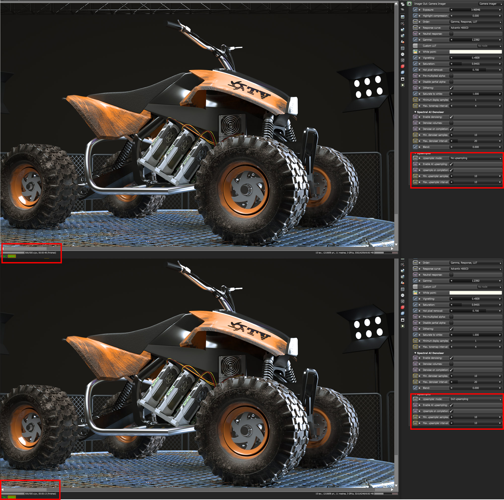

The efficacy of up-scaling depends on resolution and scene.
As you can see in my screenshot at 4000*2400 resolution is an excellent result and the calculation time is 1/4.
I would say that in animation rendering can be very helpful, in terms of time, up sampling works very well.
Obviously at low resolutions the result is less effective.
Regards
Paride
