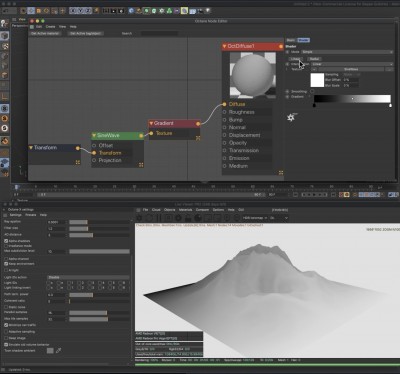

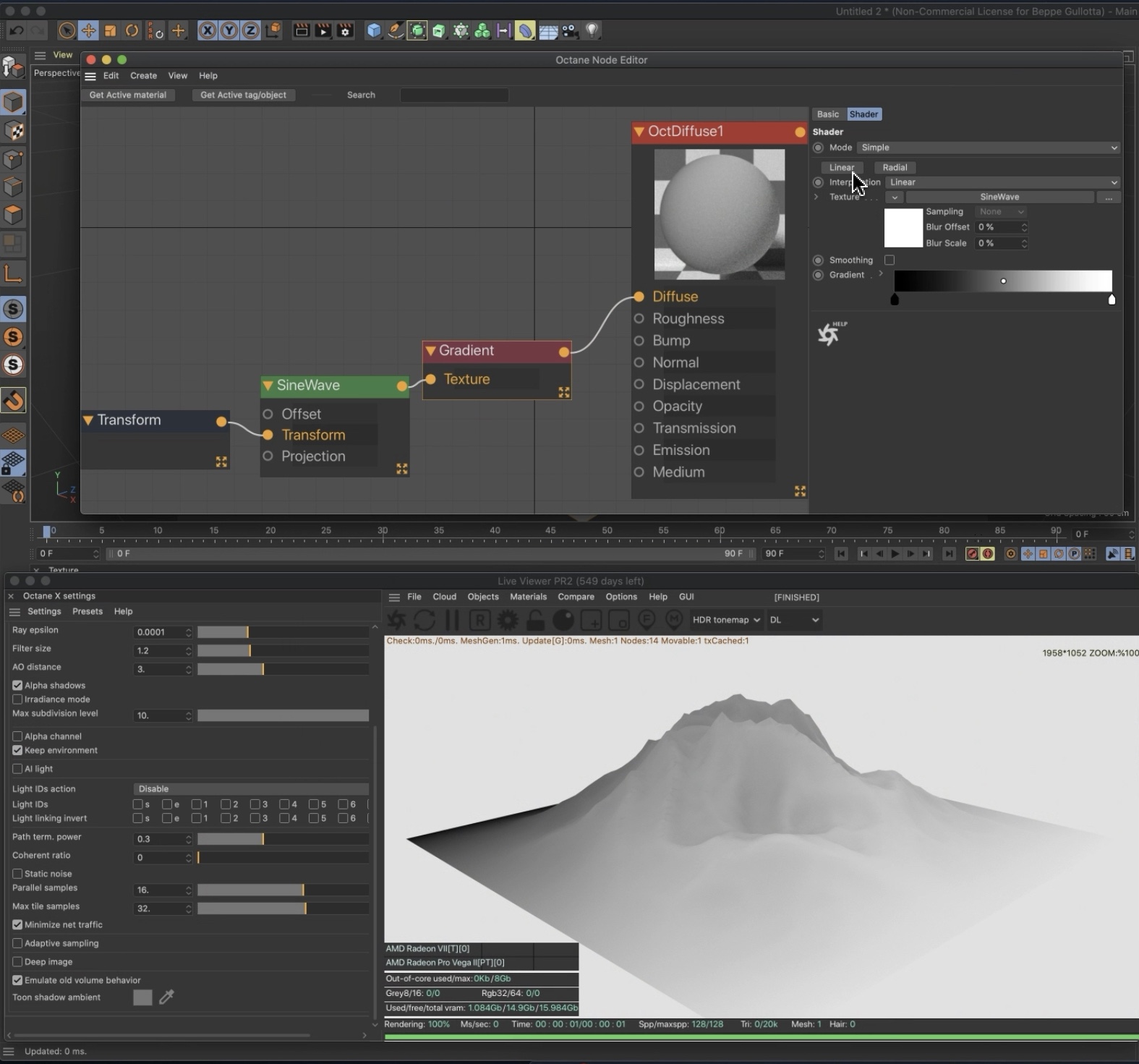

First thing to consider is that Octane Gradient is a Mapping node, not a Texture node, so it is similar to C4D Colorizer shader, and needs a Texture node to work properly.
In the c4doctane version it has a Linear and Radial buttons, to automatically create a SinWave Texture node, to make it works like a c4d Gradient Shader:

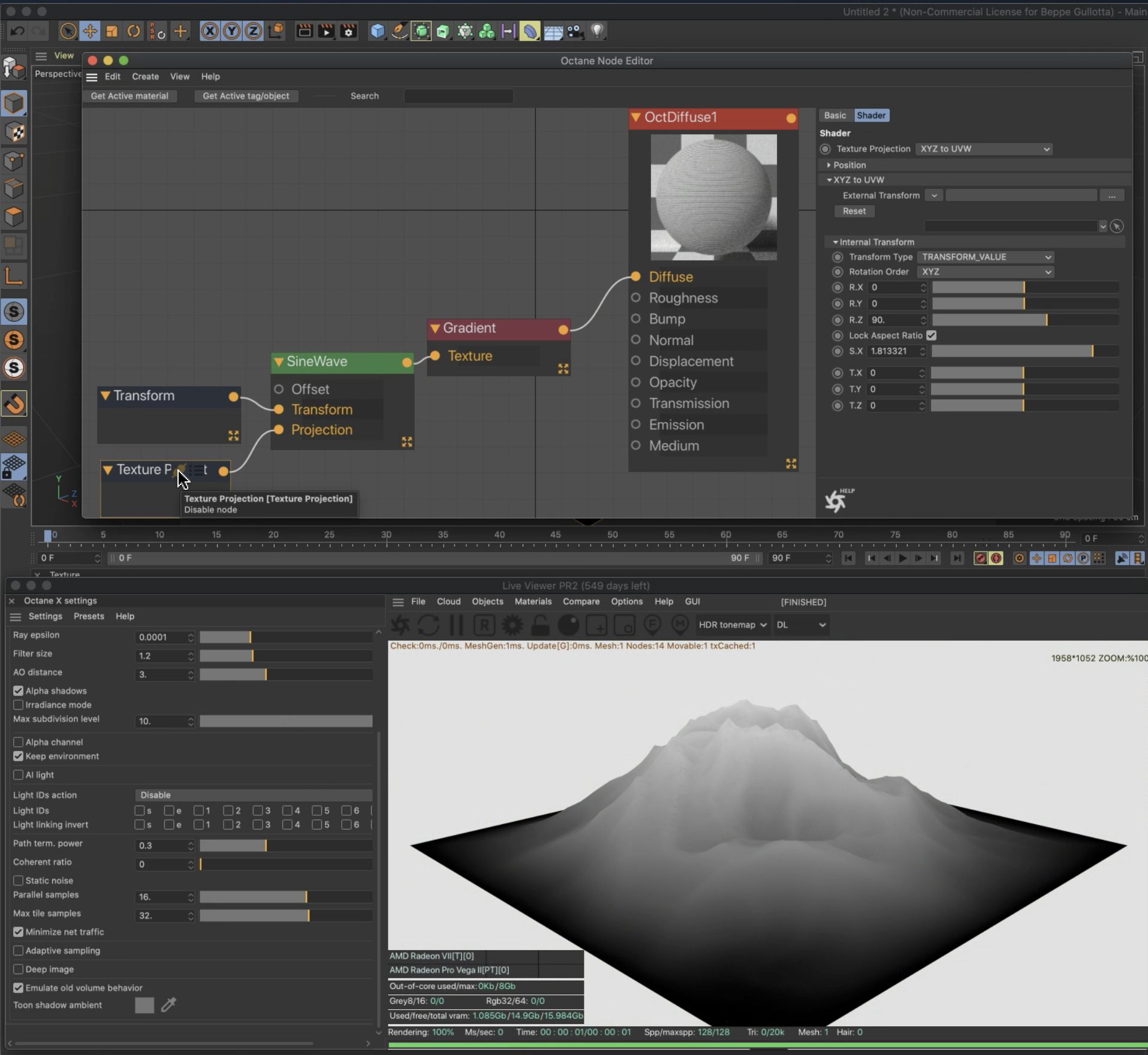

Then you can create a Projection node, connected to the SinWave node, to change the projection to XYZ to UVW (similar to Planar mapping), for example, and change rotation and scale to adapt the gradient to the mesh:
If you use a Spherical or Cylindrical projection, you can have a radial gradient, and so on.

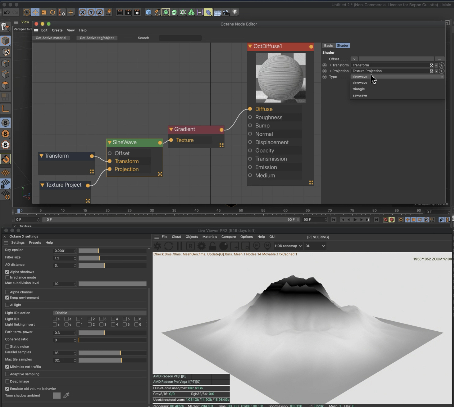

The SinWave node has three different modes, SinWave, Triangle, and SawWave, the default mode:

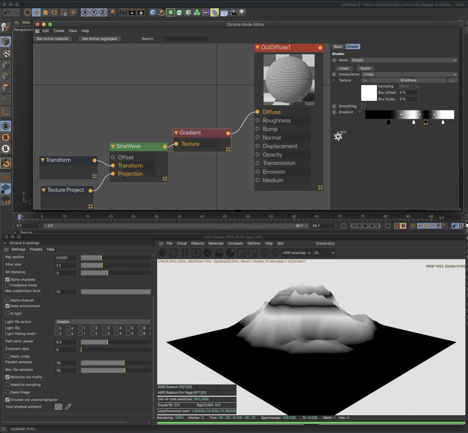

Then you can work with the Gradient node, for mapping more precisely the slope:
