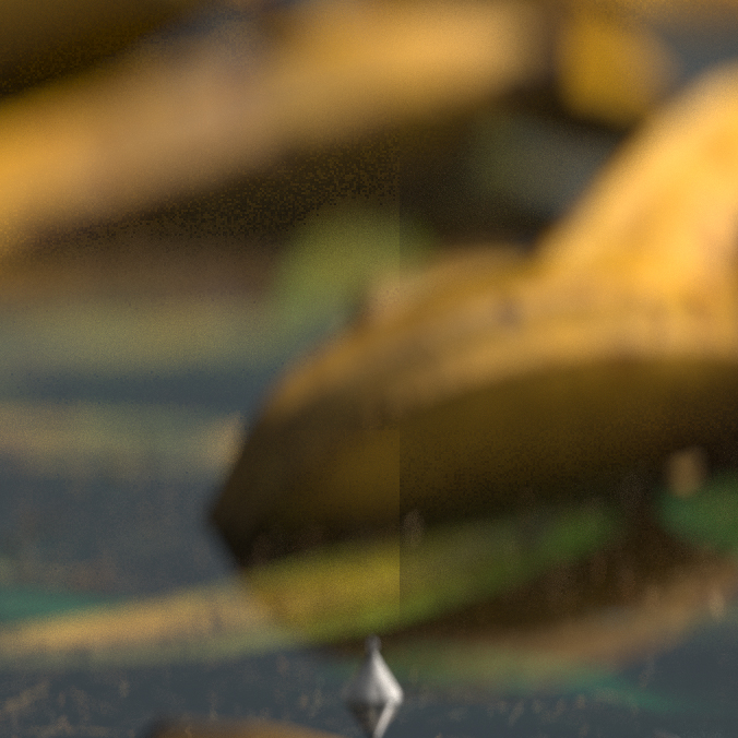

Hi everybody,

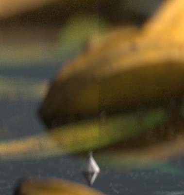

I have this problem with some of my renderings.... as you can see in the image attached, I get those blocks in some parts of the rendering. I'm using R23 with the latest version of octane 2020.1.5 R3, with 1x2080 ti (RTX active) + 1x1080 ti. Is this caused by different GPUs?
Thank you
Nik

Posts: 10613

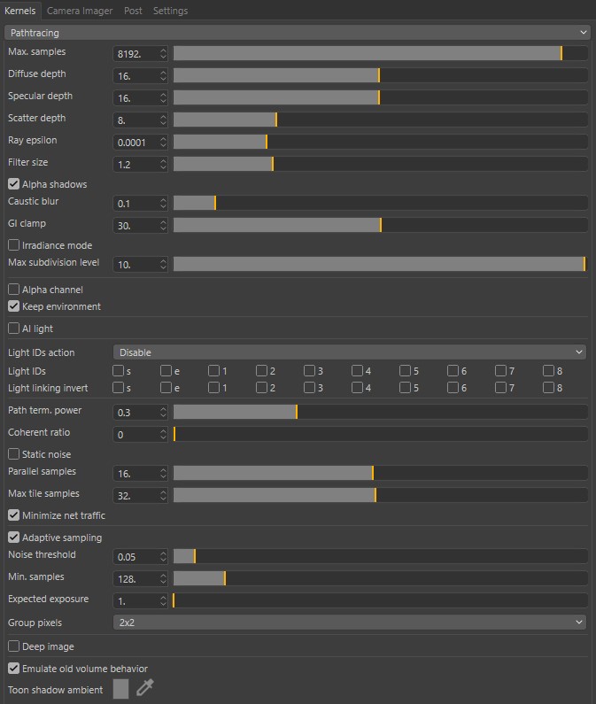

please share some screenshot from the kernel panel and Camera Imager, render Settings.
Are you using Net render?
Is the screenshot from Live View or Picture Viewer?

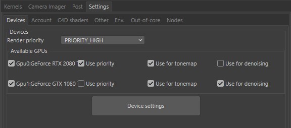

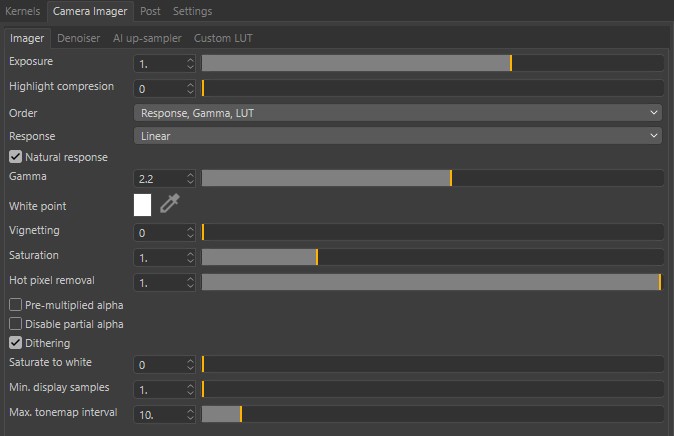

Attached the screenshots you requested.
No, I'm not using Net Render.
This problem only happen in the Picture Viewer, not in the live viewer. I've done some tests, when i'm only using the 2080ti the problem disappear.

I think that the issue is in the Devices settings, 1080Ti does not have the Tonemap active.
All the GPUs should always have the Tonemap active, unless they are connected to a very slow PCI bus, like 1x or 4x.
Also Priority is not set correctly. If a GPU is connected to monitor, the option must be enabled, and the Priority popup defines the portion of GPU power that is kept for handling system/monitor/OpenGL, LOW means roughly 10%, while HIGH means 0%.
About Use for Denoise, enable this option only for one GPU at a time, preferably a GPU not connected to monitor, or if connected, better to use the GPU connected with the monitor with lower resolution.

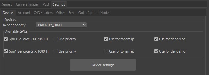

I've set the parameters as you told me (as the image attached), but the problem persist.

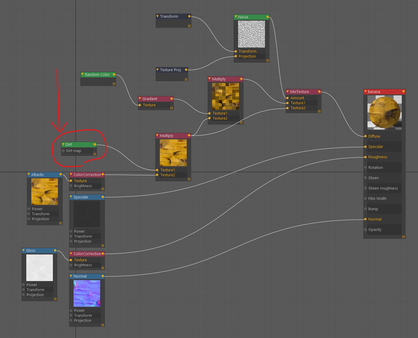

As you can see in the rendered image attached, the problem exists only on the yellow meterial/geometry, not in the blue material below. So I've discovered that is caused by the dirt node in the yellow material, I've attache the screenshot of the node editor, if that is disable the problem no longer happen.

i got similar issue with RTX ON using dirt shader.
almost same mixed gpu config : 1 rtx 2080ti + 3x 1080ti...

pxlntwrk wrote:Hi,
You are right! Without RTX enable the problem disappear!

Hi guys,
sorry but I have just tried with 2020.1.5-R3, and the only difference that I can see, compared with 2020.1.4, is that now Dirt node is rock solid, also with Network rendering, and with RTX on, the render is faster, even with Dirt node active, but the result is the same :roll:
Do you mind to share an example scene that shows the issue?
